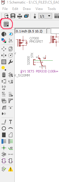

Eagle grid defaults
0.005 is also possible when you do it manually, so why would it not work as default?
Good point, I remember now; a very small grid does not display unless you zoom in enough. That threw me once.

Hy earckens,
Open the schematic and left click on the grid icon top left (circled in red) to get a drop-down menu. Then just enter the grid spacing that you want: I always use 0.05 inches rather than the default 0.1 inches. You can also turn the grid on and off from the same drop-down menu.
