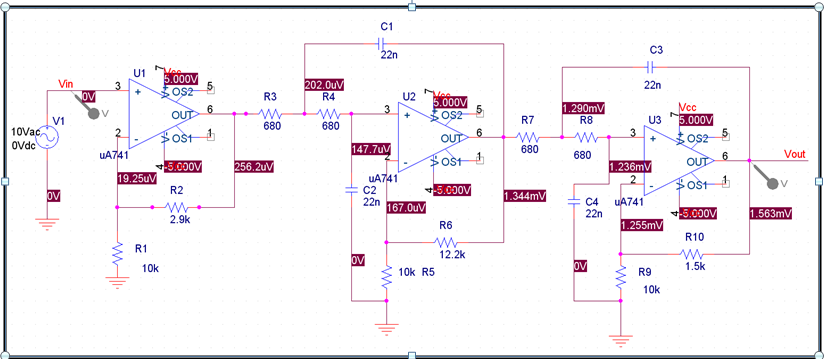

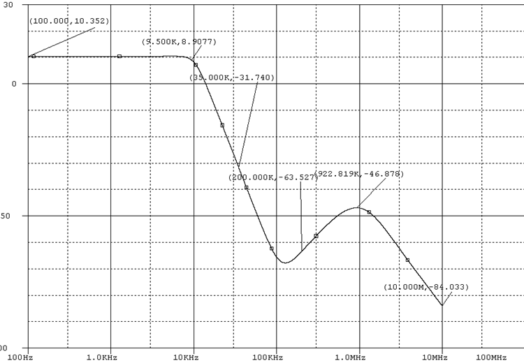

i understand that butterworth's have no ripple in the pass and stop band but my design seems to have a ripple..attached is my circuit..may i know what causes this? thanks=)

Your circuit works poorly because you used lousy old 741 opamps that are 42 years old and have trouble above only 9kHz.
It will work well up to maybe 500kHz if you use TL071, TL072 or TL074 audio opamps that work well up to 100kHz.
Your resistor values are too low. Most opamps cannot drive a load as low as 680 ohms. Look at the datasheet where they perform poorly with a 2k load and work better with a 10k load.
