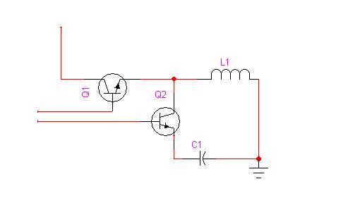

so a simple circuit like this would work?

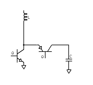

No. I think you intend to charge L1 thru Q1 and charge C1 thru Q2 but that won't work because the current thru L1 is going to ground which is the wrong direction for Q2. Q2 must be a PNP and C1 will charge to a negative voltage.
I recommend this arrangement which will give a positive output.
I don't think you can do anything with the flyback current to improve the efficiency. With the diode across the inductor (the standard scheme), the battery current ceases immediately when the diode starts to conduct. If you direct the diode current elsewhere, that current must come from the battery in order to complete the circuit, so you haven't gained anything.
