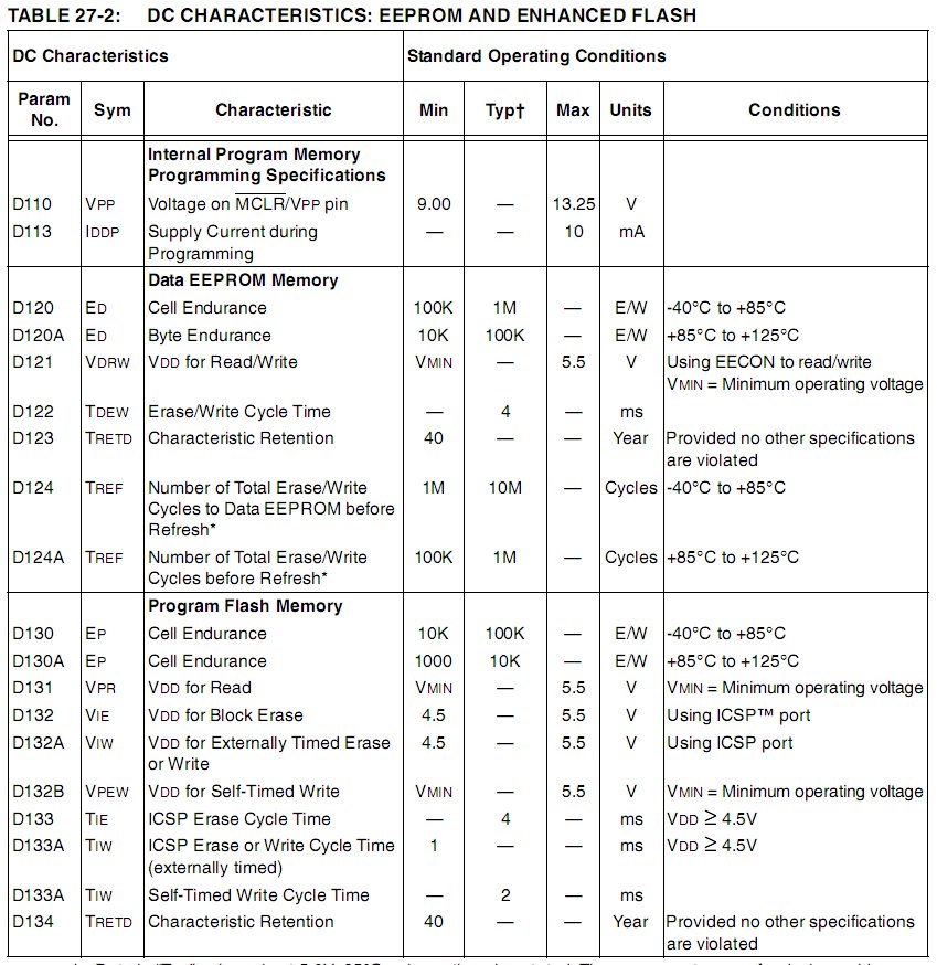

That is 100,000 to the program memory, and 1,000,000 to the eeprom minimum. If the OP is going to add some things later to make the project bigger/better, I would suggest staying with a PIC or equivalent.
EEPROM cell endurance minimum 100K. Typical cell endurance 1M.
Why is EEPROM byte endurance so much less? Minimum 10K. Typical 100K.
On the 18F's I used, it only shows byte endurance, and that is 100K min, 1M typ. One of my freinds ran some tests, and he got around 4M writes before failure. You can also switch your 4 RTC bytes you save to save to other eeprom bytes every 100 or so days to get more write cycles. If you save once per minute, you should get 2 years (1M saves).
That page I posted was for an (now obsolete) 18F248. Two years isn't too bad as long as the chip is socketed, I guess.
