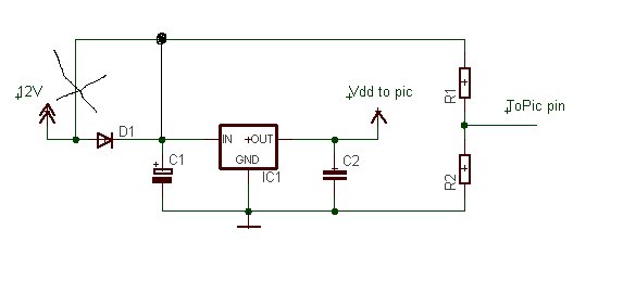

If you put a diode feeding a capacitor that subsequently feeds your 5V reg, you will have enough time after the circuit is switched off to write the time to EEPROM. You will of course have to monitor the power line before the diode with a pic input.

I've attached a diagram of how it would be connected. C1 is the capacitor that will keep it powered and the resistors should give an output of 5V when power is applied (8k + 5k). To power it for a second or two is a little ambitious, to power a single LED will take around 1000uF so to power a relay or two will take a very big capacitor. I was envisaging something like 30mS with nothing powered except the pic so that 4 EEPROM locations could be written.

Would moving the wire to the output side of the diode (cathode) protect the PIC pin if the power leads were reversed?
Mike,
It would protect the pic but would give less time. The idea is the capacitor remains charged after the supply is cut, moving the connection would delay the detection of the power off.
If you are worried about that, put another diode in front of the current one and connect the wire between them.. also keep the forward voltage drop with diodes in mind. For each diode you put in the line the V will drop by about 0.6V.

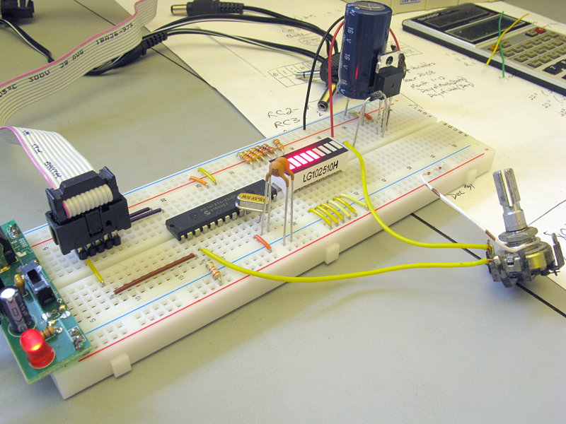

I slapped together a test power supply with a 4700uF cap on my 16F876 breadboard just to see how it would work. With seven LEDs and the 876 running I pull the power wire out and it takes approximately one second before the LEDs go out. I have to write some code to sense power failure and write data to EEPROM now. I think it should work fine. :D
The power supply at the left end is not powered. It serves as a connector for the power & ground rails and provides one more LED.
Ha! Works like a charm! Pull the wire and it's able to write 124 bytes of EEPROM before running out of juice. :D
Now to test the same thing on the actual clock...
