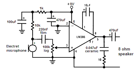

powering electrect
thanks but does it have polarity as in positive terminal and negative terminal and if so wat voltage can l use to power it?

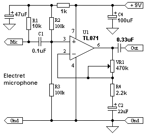

A two-wires electret mic has an output pin which needs power and a ground pin that also connects to its metal case. It can drive an LM386 little power amplifier that has its gain set to 200 or make this preamp circuit for it:
