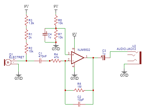

Today, I have tried to build the circuit using resistors and capacitors i have while waiting for ordered parts to arrive. I was building preamp circuit with the gain of 21 based on below schematic. R1+R2+R3 are used to drop 5.6 V across them since my electret seems to draw only 0.33 mA rather than 0.5 mA. Keep in mind that the output jack is trrs for connecting to phone.
What I found was that I couldn't hear any heartbeat, recorded by voice recorder program on my phone, using the circuit above. However, if the electret mic directly connected to the trrs jack, the sound of heartbeat could be heard from the recording. Results seem to point the preamp circuit being the culprit. I am not sure why the preamp circuit cuts off all the heart sound. It gives me concerns because the amplification is similar to the one of first stage of audioguru's circuit. If anyone knows, please enlighten me. I could also hear heartbeat using lavalier mic and phone. Below are sound recorded during my experiment.

Pretty much every electret module pre-pre-amps the signal using a j-fet.
When passive headsets/microphones are connected to a smartphone -- apple or android -- that j-fet provides the only amplification prior to the signal reaching the phones input stage; and that ppa is powered from (at most) 2.9V.
The issues of distortion due to over-amplification don't only affect this thread, but also this one and this one and many more; and the cause is always the same (person).

AG. C10 has been bypassed and the voltage drop across R13 is 1.25 V. Mobile devices need to detect whether the mic is connected, I don't think that voltage could be at 0V as you had suggested.

The mic preamp circuit I designed years ago used an 0.1uF input capacitor value that passed music frequencies, not heartbeat very low frequencies.
The preamp opamp can have a load no less than the input of an amplifier, not a speaker or headphones. The output capacitor was only 0.1uF to pass music frequencies to the 50k input of an LM386 power amplifier. Then the power amplifier drove the speaker or headphones.
