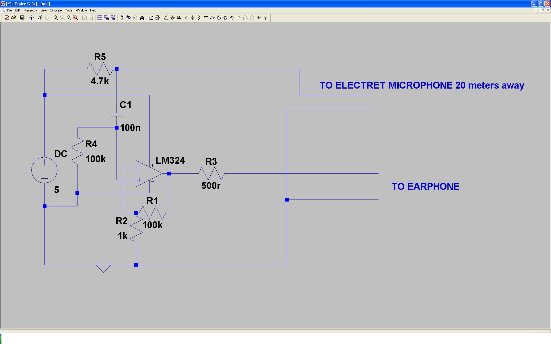

Im having some problems it works when the electret mic is on short lead <1 meter but anything over 4 meter + it picks up other radio stations and has a lot of interference how can i make it better.Ive added a rough and dirty schematic please help.

Your opamp has its (+) input connected to ground instead of to half the supply so it is a rectifier. It should be at half the supply voltage. Then the 1k resistor to ground must have a capacitor in series.
Also, low level audio signals are supposed to be connected with shielded audio cable.
The LM324 is much too noisy (hissss) to be a mic preamp. It has crossover distortion and a full output bandwidth of only to 1kHz. Use a low noise audio opamp like a TL071, TL072 dual or TL074 quad instead.
Try following some of the suggestions from Audioguru. You're never going to get very good results using an LM324.
If you really do need to use a 20 metre lead at 'mic level' it's going to need to be screened. Even then, best avoided if possible.
Better to have the pre-amp and power amp (headphone driver stage) at the mic end, and have the 'long' lead connected to the headphone output.
Does mean running the DC power up to the mic end, but it will be much less likely to suffer from interference.

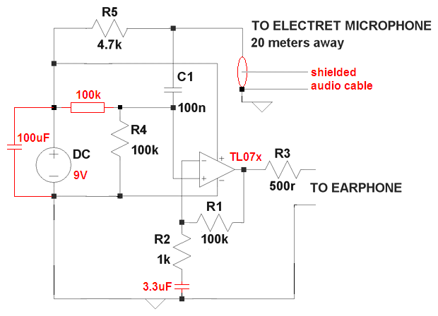

Here is the fixed schematic:

On the first pic you posted Audioguru why does the output from the mic go to the inverting terminal on the op amp i thought signals from a mic just had to be amplified not also inverted ?
On the "fixed schematic" what does the capacitor do between r2 and gnd ?
On some schematics ive seen a capacitor in series with opamp output to the earphone why is this and what does it achieve ?

On the first pic you posted Audioguru why does the output from the mic go to the inverting terminal on the op amp i thought signals from a mic just had to be amplified not also inverted?
No.
My first pic is the line-level tone controls circuit that is fed from the very low impedance output of the mic preamp opamp.
On the "fixed schematic" what does the capacitor do between r2 and gnd?
It passes some of the the AC feedback signal to ground so that the opamp has lots of AC gain. But it blocks DC so the opamp has a DC gain of 1 so that the output idles at half the supply voltage like the (+) input, so the output can swing equally up and down with the signal.
On some schematics ive seen a capacitor in series with opamp output to the earphone why is this and what does it achieve?
A circuit with a single polarity supply causes the output of the opamps to be at half the supply voltage. You do not want to feed the DC voltage to an earphone so you use a coupling capacitor to pass the AC signal but block the DC. If the opamp has a dual polarity supply like this one then the output idles at 0V so the earphone will not have a DC voltage so it does not need the coupling capacitor.

Would wrapping a layer of foil around the microphone cable help shield it from picking up interference ?

Would wrapping a layer of foil around the microphone cable help shield it from picking up interference?
Do you live in the jungle away from civilization?
Why don't you use shielded audio cable like everybody else? Many audio products come with shielded audio cables that people throw away because they use the old original cables.

Earphone/headphone cable does not need to be shielded so usually it isn't shielded and cannot be used for a low level microphone.
RadioShack and The Dollar Store both sell the same shielded audio cables except RadioShack charges 10 times as much as The Dollar Store. It is cheap Chinese junk.
Shielded audio cable on a reel is not expensive. Microphone cable is expensive because it is thick and strong so it can be dragged across a stage many times.
