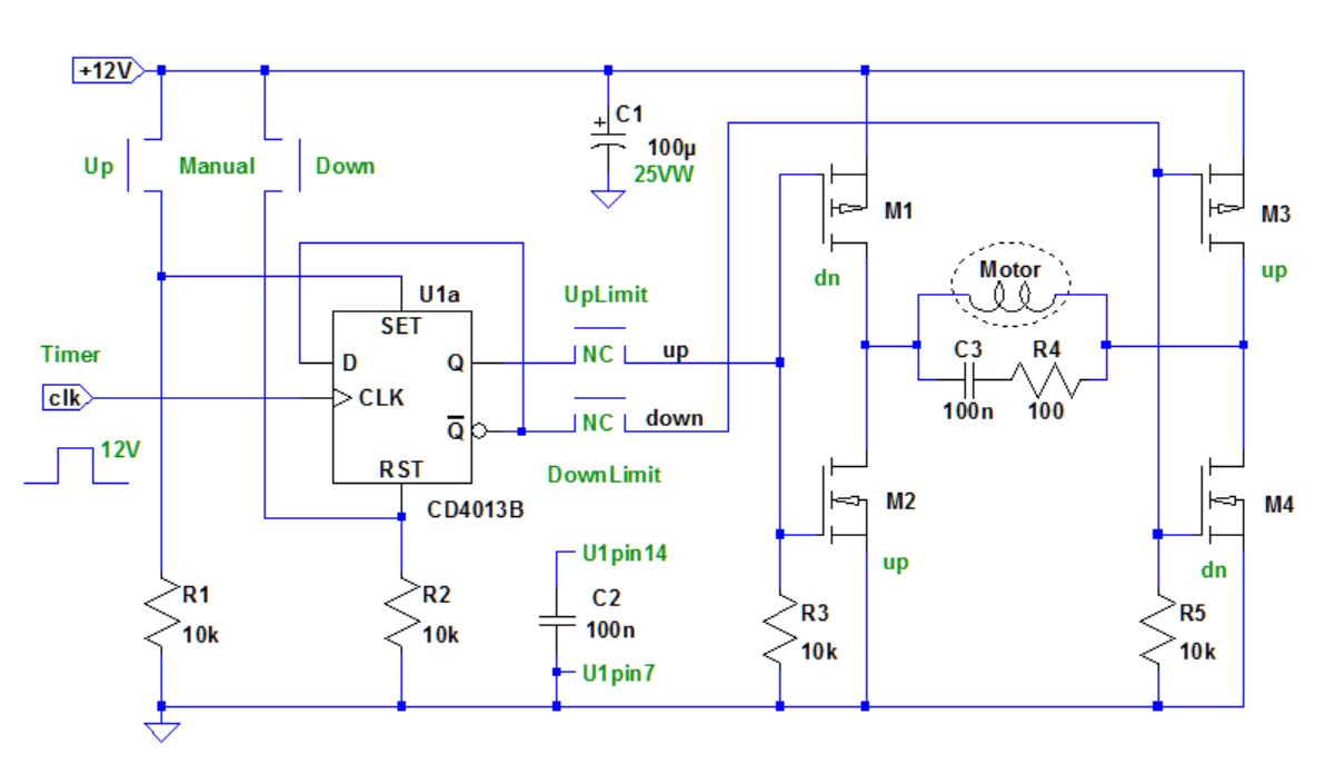

This is how I would do it.
<2A limit microswitches for open and closed to disable relay for Up and Down respectively
The timer controls On and Of which corresponds to Up and Down while the limit switches turn off the motor only in to direction to prevent the motor from stalling, but not prevent the reverse.
To implement this <$20 requires two limit switches with buttons or levers on buttons (spst) between V+ and two Relays incorporated in a winch reversal solenoid Contactor **broken link removed** rated for 150Ap.. This is the motor reversing DPDT with V+ 12V inputs separate for Up& Down
A second relay controls the direction {to signal} powered by your timer contact closure to 12V with common V-
I hope someone can redraw better using actual parts

..... and here's my offering. This avoids the need for relays, involves only small currents through NC limit switches and manual over-ride push-buttons, and has virtually zero standby current (i.e when the motor isn't actually running). Should be doable for <$10.
ok design, only corrosion issue is the limit switches need e-caps across contacts to discharge to burn off oxide.
and glitch filter on input.
appliance contacts need 10% min.of rated current as contact wetting current

I appreciate all the designs! Ive tried to take as much from them as possible, but im new to circuit diagrams so I still sometimes have questions. I'm going to give it a shot at creating one myself with minimal parts, but before I post something really stupid I do have a quick question...
  1. I'm thinking of using latching-relays (stay-relay?) in a couple places so that the system can be completely powered off when the motor isn't running. Is this reasonable?
  2. In my draft diagram I have a couple places where the throwing of a switch needs to perform multiple actions. I have no doubt that that is possible - however one of the actions is actually un-latching the power going through the switch itself. So I basically want the switch to trigger some relays momentarily and also cut its own power via a latching relay upstream. It sort of implies that all these things need to happen simultaneously. Is that sort of thing a bad practice? Or prone to failure?
If Im not describing this correctly I can try to draw it out...
limit switches cut the power in one direction only.
what is overall requirement for control? input , controls, output?....
Ah, good point - I guess what Im saying is that the limit switch is being used to apply current, not to cut it. This current is then being used to alter the state of other latches in the system. Maybe that completely defeats the purpose of limit switches, since they are designed to act quickly when a limit is reached?
I guess I should redesign my system with that in mind? I understand how I could use that switch to kill the motor, but I also need to use that switch to alter the state of the system at the same time, because it's acting as the reversal signal.
Should I scrap the "limit" switch, and use a "momentary" switch? Which I think can be used like a normal switch, to apply current when the door pressed against it?
maybe you should redefine required inputs & responses and stop thinking about how to implement.
