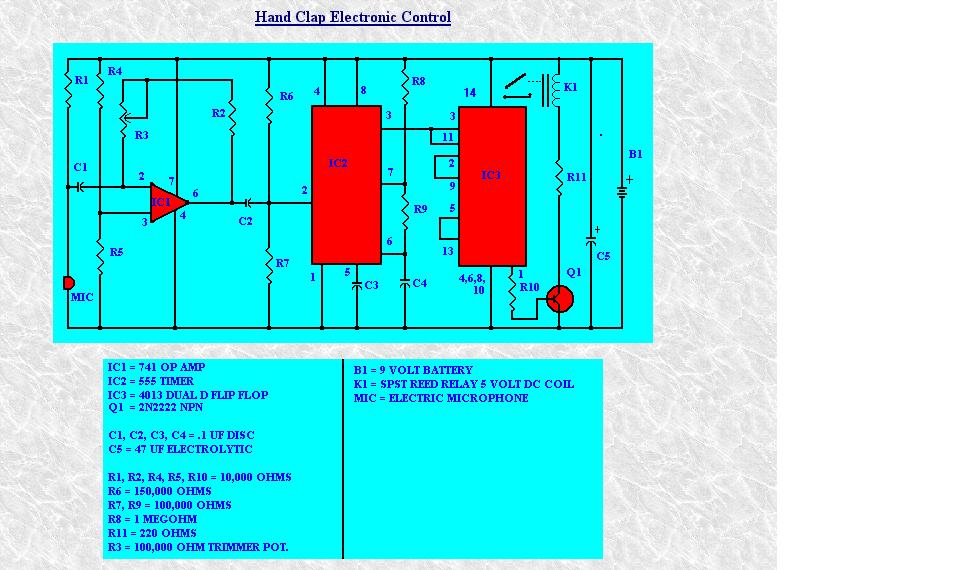

hey any problems in this circuit??
It is not a circuit. It is just a bunch of wires that connect boxes together. I guess IC1 is an opamp and IC2 is a 555 timer set up as a monostable. IC3 could be anything.
A circuit has part numbers for its parts, yours doesn't.
It looks like the relay will be activated each time you bark (clap?).
Most clapping circuits hava a counter so two claps are needed instead of just a single noise.
Teh designer and somebody else have terrible spelling.
What is an "electric" microphone??? It is an "electret" microphone.
