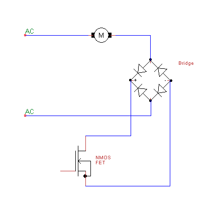

hi,,how do i connect properly the optocoupler with IRF350 mosfets that would control an 8Amps, 220v Ac Motor??
my problem is i dont know how to properly connect the optocoupler to the gate of the IRF350 mosfet..
pls post any schematics that would help me...
thanks n advance...
Is the circuit just a replacement for an AC relay, or are you trying to vary the speed of the motor by chopping the AC waveform? The answer has to do with how fast, and how often the mosfet is turned on/off?
Are you aware that there are commercial products called SSR (solid-state-relay) that are specifically made for this task?
yes this is just a replacement of ac relay..
the only function of this circuit is only to turn on and of the motor..
how often?? the answer is hours or even days...
i need some schematic to completely connect the optocoupler with the gate of the mosfet..tnx
i got here a diagram but i doubted a 15v with 1k resistor is conneted to the output of optocoupler.. is this ok to connect 15v to the output??

Inside an ssr is the optocoupler, the triac (not mosfet) and its firing circuit. If an 'ssr' had no choice but use a mosfet, it would have a bridge rectifier included.
do u mean i need to have a bridge type rectifier connected in the mosfet to make it DC so that the mosfet woks??
does an AC Motor works with
DC??
A single MOSFET will not work as there is a body diode that will conduct on reverse cycle. It is possible with to series P-Ch, N-Ch MOSFET's but drive circuitry is complicated.
Stick with Triac's with opto-isolator diac trigger.
If the motor has brushes (like power drill) it will run on DC.
i think motors used in the industrial conveyor is a brush type motor so i may be run it using DC...
this is a requirement for me to use mosfet but if i would decide for my own i would stick to TRiacs and relays..

If the obsolete IRF350 MOSFETs are cheap, (they should be), you can reduce losses to almost nothing by eliminating the diode bridge and connecting two MOSFETs in series, source to source and gate to gate. Use the two drains as your switch terminals.
Drive the gate as you would normally, with the sources as common.

i posted an atachement. pls. evaluate this circuit if you think this would possibly work before i may buy this components..just to be sure a little.

Your 5V, 15V and Ground to the right of the 6N137 must be isolated from the logic circuit and Earth and people, etc.
how about this one?? which is much better of my two circuits??
never mind the two 2n series transistors 'coz that is not final just see if that design would trigger the mosfet..
