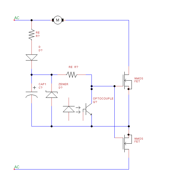

electronic switch with Optocoupler and IRF350 Mosfet
hello! we have the same project Romel, I'm looking for a schematic diagram for the connection of the two components..

Definitely, we are in the same college. Anything you could share mate? I am looking for this in google, the schematic diagram of these optocoupler and fet connected together and function as a switch to a motor. Any advise?
Have you looked at using a solid state relay?
No, we are not instructed to use such relays. We must focus on using an optocoupler and a FET(IRF350), any ideas? I don't bother to ask questions about using another device because our Professor will just ask me if I'm listening to his instructions or not. His instruction is just to use an optocoupler and a FET, connect the two and make it function as a switch for an AC motor.

Here is a crude circuit which will work. There is a better, more efficient way of supplying the gate voltage which I'll leave up to you since this is a school assignment. Same goes for the component values.

both kchriste's circuit is working..but i did my own circuit from kchriste's idea. i just did a little revision...
