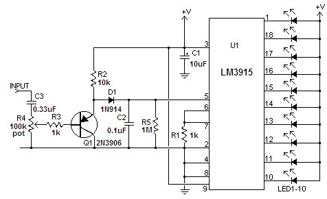

Hey guys, I need to build an LED VU Meter for my electronics project which I have to submit by the coming week. I searched quite a lot on instructables and on youtube to see how it is and all, but frankly I'm spoilt for choice. I found this one linked below which I liked and I have all the components ready with me to build it, but earlier in the day today I realised that it was a Sound Level Meter ( I donno the difference). https://www.aaroncake.net/circuits/vumeter.asp

The input transistor on the Aaron Cake's circuit does not work properly unless the signal level is very high but the LM3915 is not set up for such a high input level.

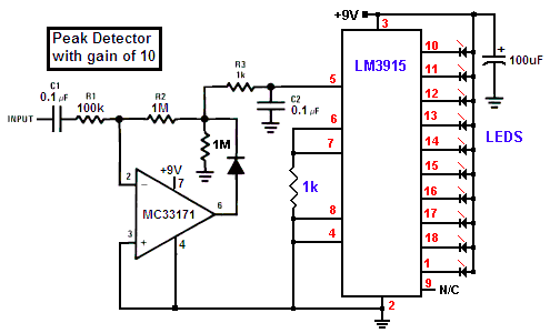

The input opamp on the "VU Meter With Gain has gain that is too high for most uses.
The "VU Meter" is Aaron Cake's circuit again.

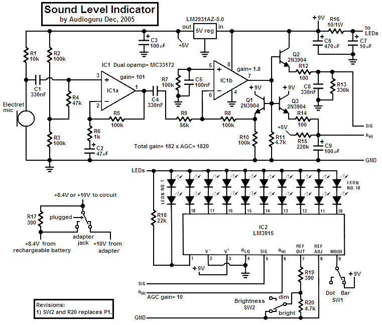

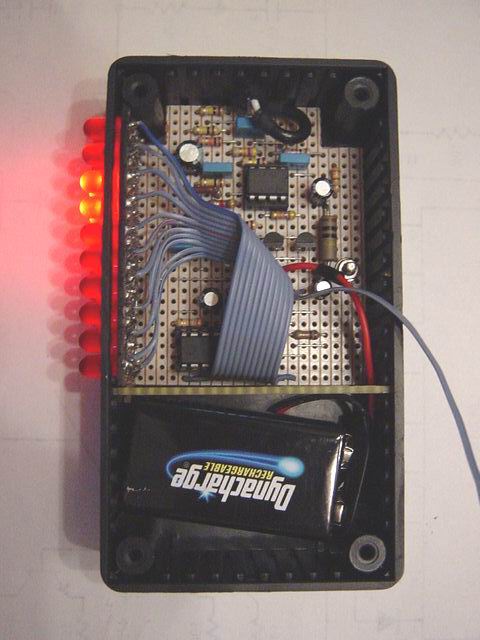

I have a VU meter with a microphone. It also has an automatic level circuit that boosts its range. It is this one:

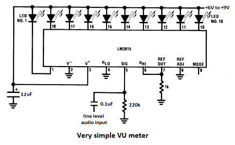

Here is a very simple VU meter. The datasheet for the LM3915 explains what the parts are for but ask here if you need an answer.

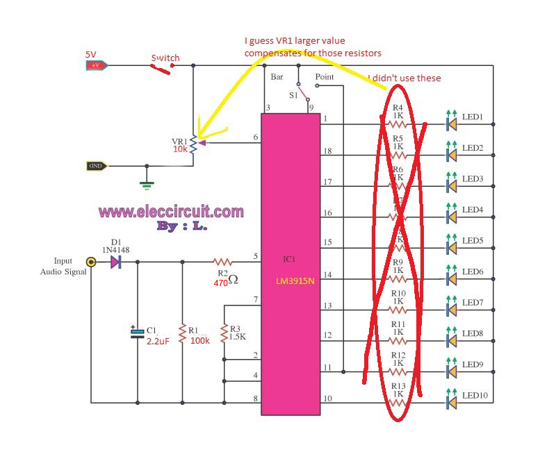

Lastly, I found another Vu meter on youtube which seems quite good too....
Here are the schematics taken from the same video......here again my problem is the audio input part, the rest of it I have understood quite well.
Thanks for all the support uptill now, you have been really kind Sir...
Schematic - VR1 is a 10k pot

You talked about and showed videos of the VU meter LEDs responding only to THE BEAT and not to the music. Then the circuit is fed from a sub-woofer amplifier or it has a very good filter at its input.
The last schematic you posted shows current-limiting resistors for all the LEDs. The datasheet for the LM3915 explains why they are not necessary: The IC Limits The Currents. The rectifier diode at its input spoils its action at low levels. An active peak detector circuit using an opamp should be used instead that is shown in the datasheet. Its VR1 adjusts how much signal level lights how many LEDs.

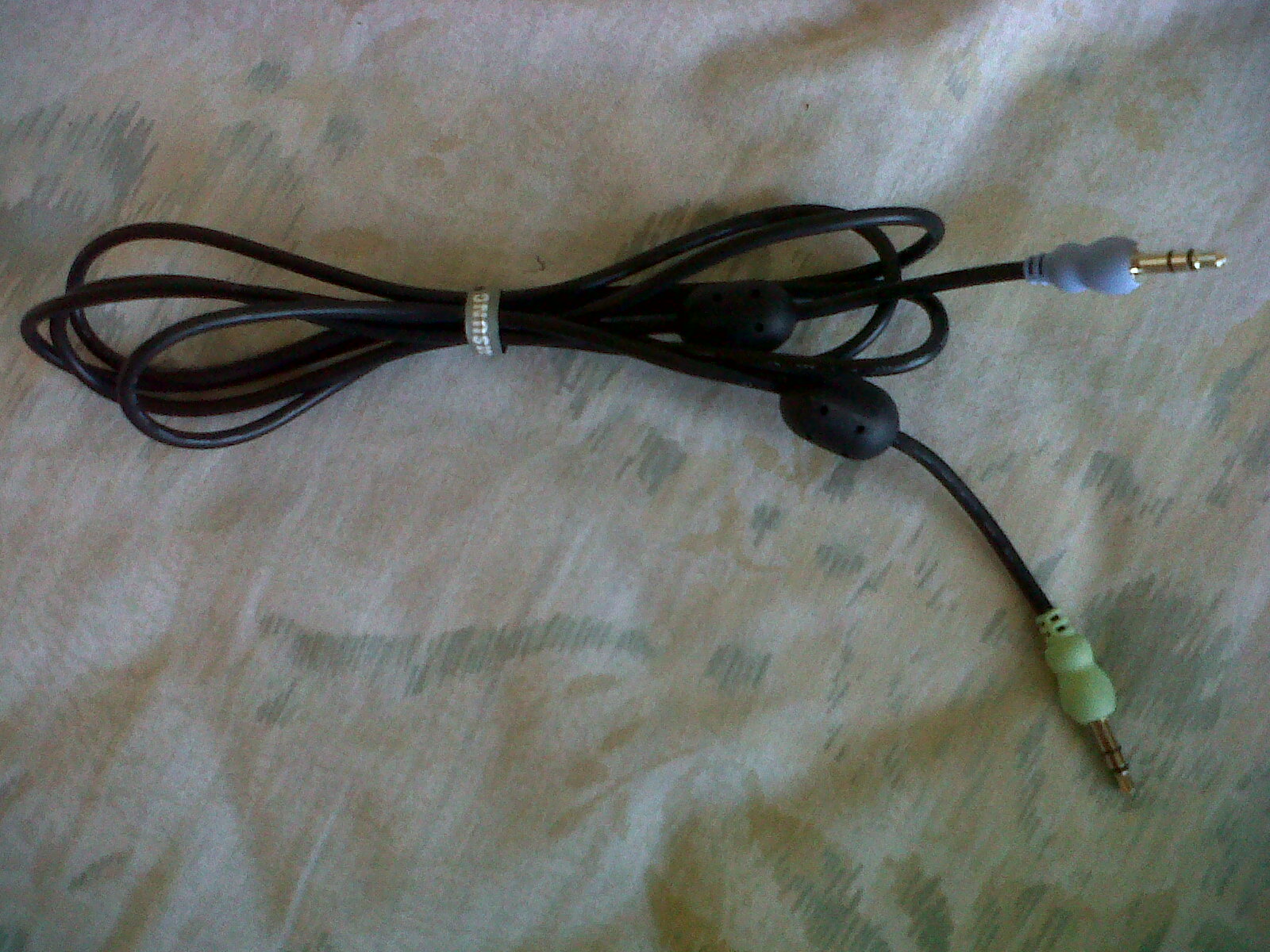

Ok, so I've been to the electronics hardware store and have bought the necessary components for the circuit below (posted earlier).
He has given me this audio jack which is a 2 ended 3.5mm jack. So basically(correct me if I am wrong) what I have to do is insert one end into my phone/ mp3 player and about the other end, Ill have to cut the wire in between to obtain the 2 wires inside and make the stereo to mono conversion and apply it at the place marked audio input...

Just use the left side if you want to make it easier.
If you want to display EVERYTHING that is in stereo converted to mono then the new cable has one end cut off and its two audio wires connect to the two resistors that make the converter. The shield wire must connect to 0V of the VU meter circuit. The free ends of the two resistors are connected together at the input of the VU meter circuit.
