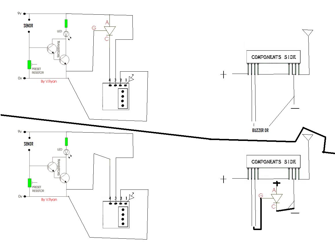

colin886 New Member Apr 3, 2007 #1 Hey,im doing a project where i have to make a simple alarm that detects if the light level reaches past a certain amount.I have come up with an idea with the help of a few websites but im stil not shure if one will work. thx the one part thats pins are G,A,C is a scr it uses the rf tranmitterand reciever from http://www.robotshop.ca/home/produc...elemetry/on-shine-high-sensitivity-tx-rx.html Attachments BASIC SENSOR.jpg 64.6 KB · Views: 160 Last edited: Apr 3, 2007

ericgibbs Well-Known Member Most Helpful Member Apr 4, 2007 #3 colin, Looked at your drawing and link. On the link, the information regarding the inputs/outputs is missing.? Your transmitter SCR will never switch ON, the Gate is grounded [0V]. The Receiver output, may not be able to drive an SCR, if it did, how would you switch OFF the SCR.? As already suggested, have a look at some comparator information.
