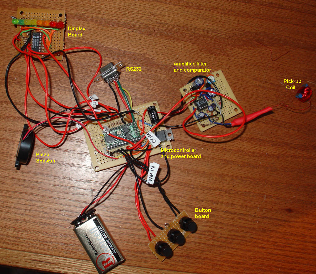

Hi folks... I've been developing a homemade EMF meter with LED bargraph display, and am looking for some tips on tweaking the EMF sensing circuit.
I don't have a schematic for my actual circuit handy (circuit's at home, I'm at work), but it's based on this one:
For my first couple questions, look at the left side of the circuit (sensing coil and op-amp). When I wired mine the way shown in the schematic, it wouldn't pick up anything. I didn't have a 1mH radial inductor handy, so I fashioned my own using 30ga enamel wire and a round core (100 turns or so, give or take). But, if I disconnect the side of the coil going to the + input on the op amp in the schematic, leaving it free floating, then I can pick up fields. So, in essence, it's acting more as an antenna than an inductor. Any thoughts on this? Maybe I need a better coil?
My 2nd question: the circuit is a LOT more sensitive if I connect it to an earth ground, such as when I connect the grounding clip on my oscilloscope when taking readings. Any thoughts on this? Since I intend this device to be portable, I can't be earthing it all the time.
At present I'm using a TL082 op-amp, but I just got my hands on some LMC6482 CMOS rail-to-rail op amps. Do you think that one would work better for this? I went with the rail-to-rail so I can get a better range in the comparator portion in my circuit, not in the schematic above. I am using a Basic Stamp 2 feeding one side of a comparator with a filtered PWM signal, and the other side is a filtered and amplified version of the EMF signal, and the uC uses successive approximation to determine the signal level and it lights up the bargraph display and beeps a piezo transducer based on its measurements.
I'll post a more complete schematic this weekend when time permits, but thought I'd post what I have in case anyone has suggestions for making it better!
Thanks,
KJP
100mH is a lot of turns. I suspect that the coil you made only has a few 10s of uH.
Any low input-bias-current opamp would work. Rail to rail is not a requirement. \
What frequency range are you internested in? The circuit as drawn is only capable of responding to a few 100 kHz.
So, more turns then? Threading that thin wire through a 3/4" doughnut killed my hands after a while. I suppose I can go hunt down a pre-made coil... but then there's online ordering and shipping. I don't have anything to measure inductance either, but I'm sure the mH/uH value doesn't matter as much as how many turns, right?
Maybe cut a doughnut in half with a hacksaw, then coil the wire on one half, and then glue the halves back together would work ok? Does the doughnut have to be intact to work properly? What if I cut a notch out to aid in winding?
I think you want an open coil, not one wound on a toroid. Toroids are self shielding, and the only way to induce a magnetic flux in them is by passing current through a winding. Since you are trying to intercept a magnetic field that happens by, you want an air-core coil, or a solenoid wound on a ferrite rod.
where is the 100 mh coming from? I only see a 1 mh in the schematic.
He probably meant to say 1mH.
So, what if I don't have a ferrite rod handy? Any common household items that would work? Maybe a nail? Ok, that brings back old memories of making electromagnets out of iron nails, some wire and a battery. ;) Or I could run to RadioShack and pick up the (I think) 100uH ferrite choke, and just wind a new coil on that core.
If an air core will work, I could just use the remaining spool of enamel wire as the coil.
As for the toroid, I only have one side of the doughnut wound with wire, so that should defeat the "self shielding" you would normally get, right? I figure this would make the pickup less directional.
I think I'll try cutting a notch out of a doughnut (I have a bunch of them) and then spend some quality time winding it and see how it works.

Ok, any suggestions on how to improve this? Limited in terms of low frequencies, or high? I'm not real concerned with high frequencies (above a few tens of kilohertz) anyway, but if I can have it able to detect very low frequencies (down to a few Hz or so) that would be ideal.
I'm not so good in the analog department. Someone else should be able to give you an idea of it's bandwidth. The range is going to be pretty limited though, and in a house you're you're going to pick up almost nothing but 60hz hum from mains pollution.

As the circuit exists now, it can pick up noise from various devices in my house. The strongest emitters seem to be CFL light bulbs, which can peg my breadboard prototype from 2 feet away. Other devices, I have to put the coil right on them for it to pick them up. So I'm still fine tuning the thing.

All that being said, try using the loop antenna from an old AM radio. You may need something with even more turns than that to get an decent reception. Maybe a few AM antenna coils in series. Maybe 3 in an inverted U configuration.
Here's a pic of the project as it currently exists. I still have a couple components to add (power LED and headphone jack), then I'll start stuffing everything into a project box.
I ended up snapping a ferrite doughnut in half and wrapping the heck out of it with enamel wire. That, plus switching to a rail-to-rail op-amp for the preamp and comparator gives me some extra sensitivity.

CFL's run at a pretty high frequency, 10-100khz. I think all you really need to do is really step up the coil turns. That looks like red magnet wire which I'm guessing is 30 gauge, try something smaller like maybe 40 gauge it's not gonna cary a lot of current, wrap the coil around the core of an AM loopstick antenna (they're easy to strip) The length of wire you need is REALLY long though. 4X or more what you're using.
