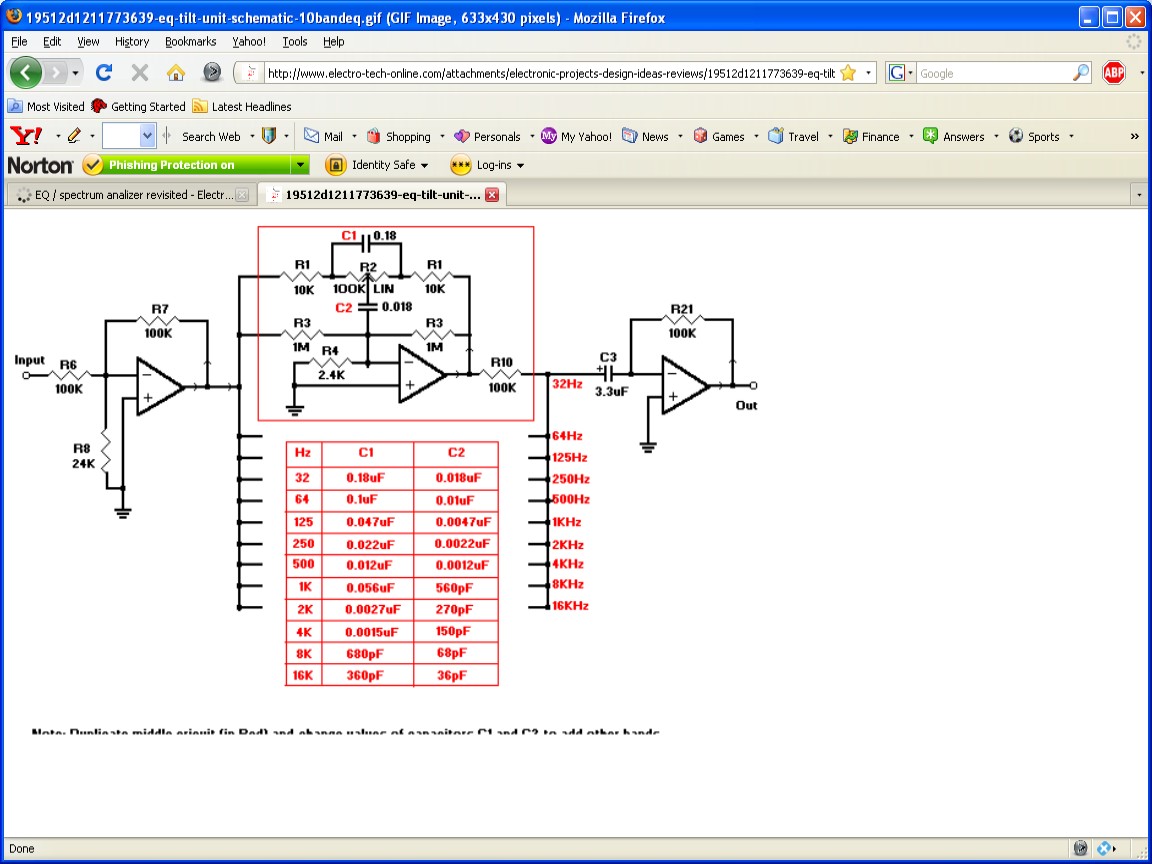

The schematic shows U4 pins 8-10 as an inverter. In TINA it is probably completely different, maybe it is the mixer.
If I remove U3 pins 5-7 won't the display circuit mix the filter outputs all together?
The schematic shows that the input of U3 pins 5-7 is from one filter. The filter drives only one the display driver, not all of them.
U3 pins 5-7 is shown driving only the input of inverter U4 pins 8-10. Both opamps are doing nothing.
The mixer is not shown on the schematic.
Only have part of mixer

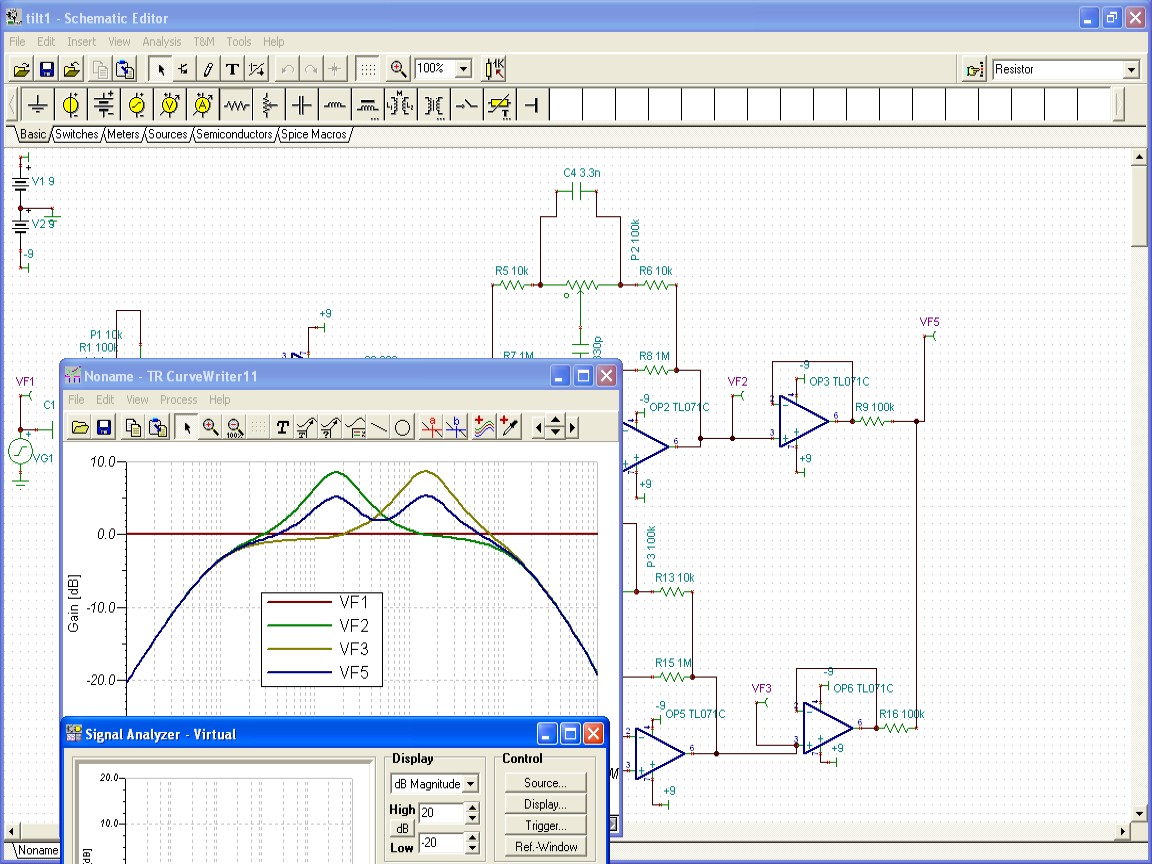

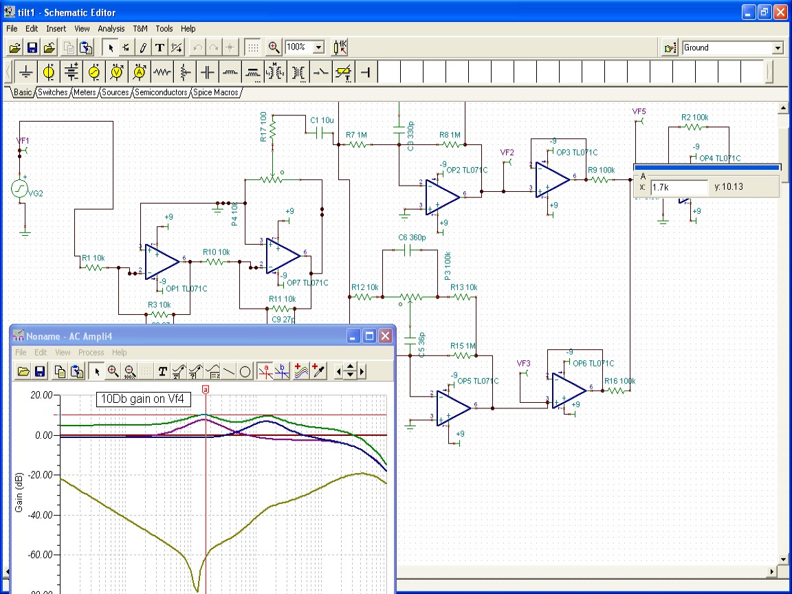

here is a pic of TINA with the 47K resistors removed and all 4 mixer inputs included.
the outputs at Vf2 & 3 drive two seperate displays. have a total of 10 displays (5 right, 5 left).
Tina is showing two display driver outputs Vf2 & 3.
will simulate with filter pot at 10% and 90%
the 10K mixer input pot set at 50%

pots set at 10% & 90%
screen shot one mixer input, filter pots at 10% and 90%

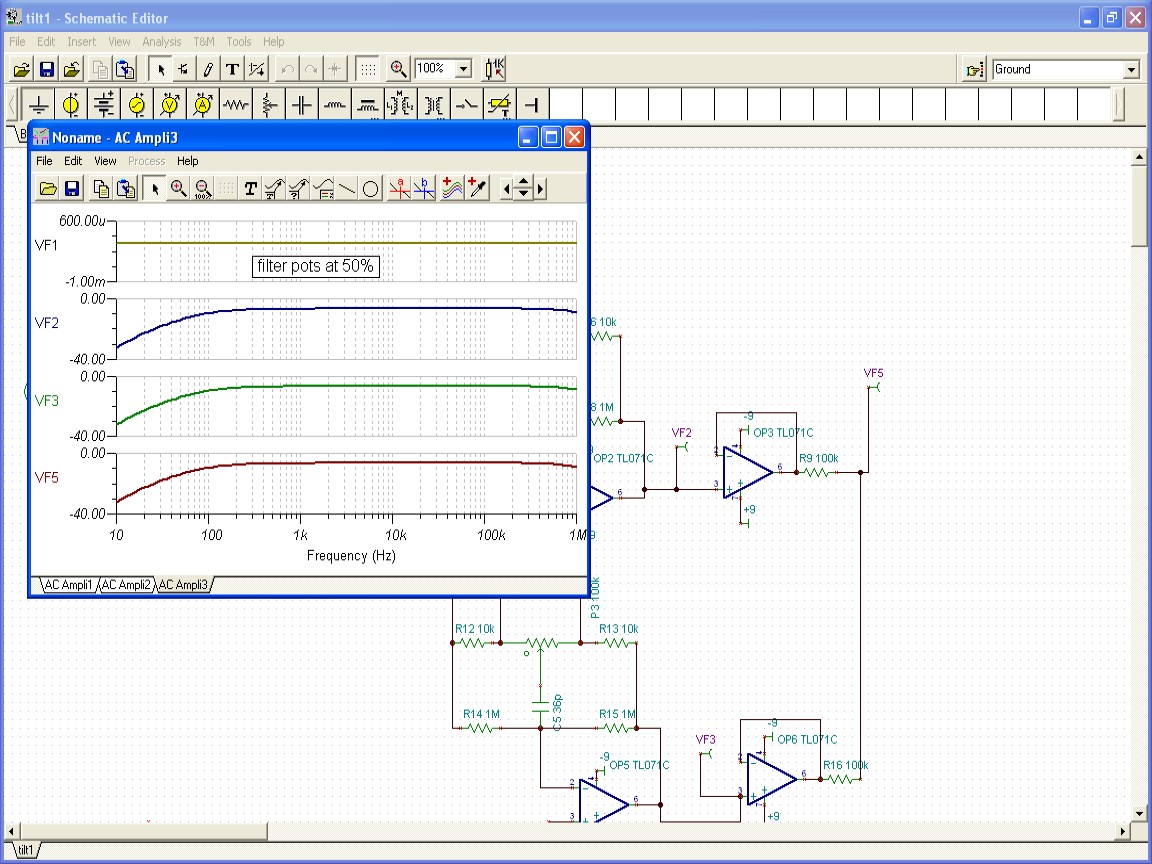

filter pots at 50%
here is both pots at 50%
these shots are with out U4 pins 8-9, the 47K resistor is gone as well.
Maybe I am wrong but the U3 pins 5-7 are acting as a buffer to isolate the different frequencies to drive the displays??

Your TINA simulation does not have decibels scales so it is almost meaningless.
The simulation shows a small amount of boost and cut.
the simulation shows no bass frequencies because the load resistors on the coupling capacitors have a value too low and act like highpass filters.

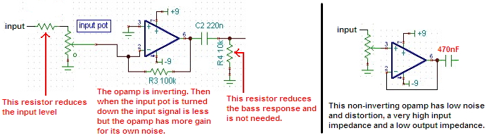

What are you doing?
The input opamp is inverting but it does not have an input resistor to set its gain. Then it is extremely noisy when the input pot is turned down.
If you do not want a mixer at the input (a mixer is an inverting opamp with an input resistor from each source) then the opamp should be non-inverting.
EDIT: Modified the input opamp.

I thought I had same as your post
with the mixer inputs (several 100k resistors connected to the inverting pin (-)
if connecting inputs to a stereo, radio, tv set etc do I want high or low impedence?
my bad
I connected to 100k resistor going from the input to the output on the wrong pin.
I took out the one resistor to groundchanged the cap to 470u as suggested.

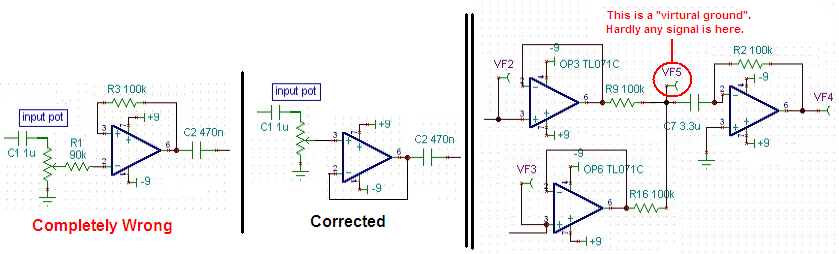

You messed up the input opamp so it is inoperative.
Vf5 is an extremely low signal voltage mixing node. Vf4 has the mixed output signal.

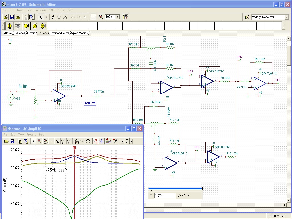

I redid TINA using your mixer
I found an interesting artical talking about mixers
Simple Mixer Schematics
Just for the learning process I inserted drawing # 3
The outputs look exactly the same??

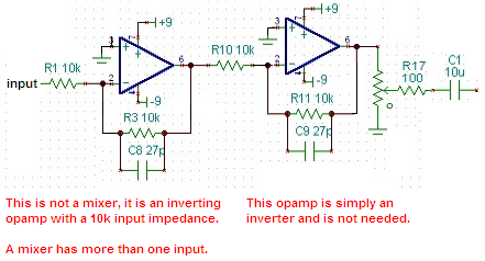

I thought you knew that an active mixer uses an inverting opamp and every input has its own input resistor.
But you do not show a mixer because yours has only one input. It is just an inverting opamp.
The second opamp is just an inverter and does nothing.

only simulating one channel
I can't simulate more than one input.
the schematic is of one channel with one input.
I added some extra inputs in attached.

VF5 is a virtual ground without a signal voltage. It has some low and high frequencies because of the phase shifts of the filters and because C7 has some reactance that blocks some of the virtual ground effect.
The output is VF4 which shows two peaks at +10db.
Try simulating it with C7 replaced by a piece of wire.
OP3, OP6 and OP7 can be removed with no change in how the circuit works.

inserted piece of wire = only VF5 changed
Yes only VF5 but were most frequencies at -75dB?
I want to keep op3 & 6 to act as a way to isolate the outputs of the filters instead of one output to the displays I have 5 per channel
I simulated without OP3 & 6 and all the peaks are then on the one output.
remember I have 5 peak detectors/displays per channel
The filter's opamp drives only its own peak detector. Adding the tiny loading of the output mixer makes no difference. OP3 and OP6 do nothing.
The output mixer is supposed to mix the frequencies together.

I want the displays to show what each filter seperatly is doing. without op3 & 6 all the signals are mixed together so all the displays will show the same.
as for the op7, I will take it out as it really isn't needed. I just inserted it as the artical showed it in the circuit.
took out op3 and 6
left the 100k resistors and I still get seperate waves for each filter.
Vf4 has all and vf2 & 3 have their own wave.dosn't look like I lost any Db gain. still at 10db

See how the VF5 now has a frequency response now that is the inverse of the open loop frequency response of the last opamp?
True, the design does not use VF5 as an output.
The output of a filter feeds its own LM3915 display. It also feeds an input on the output mixer so that the audio of all frequencies are mixed together. Each display is separate from the other displays with or without OP3 and OP6. So remove OP3 and OP6.
