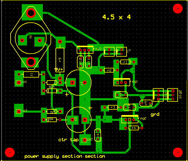

corrections and pcboard
the pc board traces are all .050 in width.

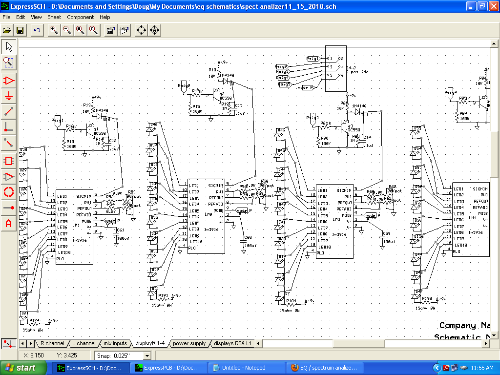

have 10 lm3916 display drivers with 10 leds per see attached

You have the input and output pin numbers backwards on the LM337.
R3 and R4 are reversed as well
Rechecked the data sheet on the lm337 - your correct on being backwards-corrected
maybe a larger resistor for the common on the led displays?
have seen the lm3916s on 12v w/o a resistor?

need a bigger transformer and check specs on traces carrying 2A
With a 9V supply, the LM3916 set for bar mode, all 10 LEDs lighted at 15mA each and 1.8V red LEDs then the total current is 150mA. Each output of the LM3916 has 7.2V across it so the total dissipation of the LM3916 is (150mA x 7.2V=) 1.08W so it will be extremely hot. Its max allowed dissipation is 1.365W for the DIP package.
Your 15 ohm common resistor for each display dissipates (150mA squared x 15=) 0.34W so the LM3916 dissipates (1.08W - 0.34W=) 0.74W which is still pretty hot.
If the common resistor value is changed to 27 ohms then it dissipates 0.61W (use a 1W resistor) and the LM3916 dissipates only 0.47W.
Revised schematic
Still need to change the common resistor to 27 ohm at 2w resistors.
made changes to caps (that 4700uf has 10mm lead spacing!, one big cap) corrected the R3 & R4
took out several caps
hopefully this is right.
