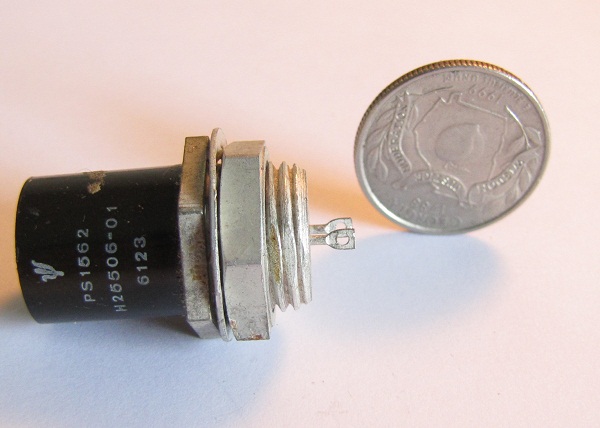

May have to bin this...:eek:
Mercury tilt switch?
Thats a cool tx/rx board Nige, I'll have to get me one of those, 5 is a bit much though.
Well you need at least two in order to use them :D
They do sell them in ones, but I ordered five - as you never know when you might want some, and they take a long time to arrive from China.
