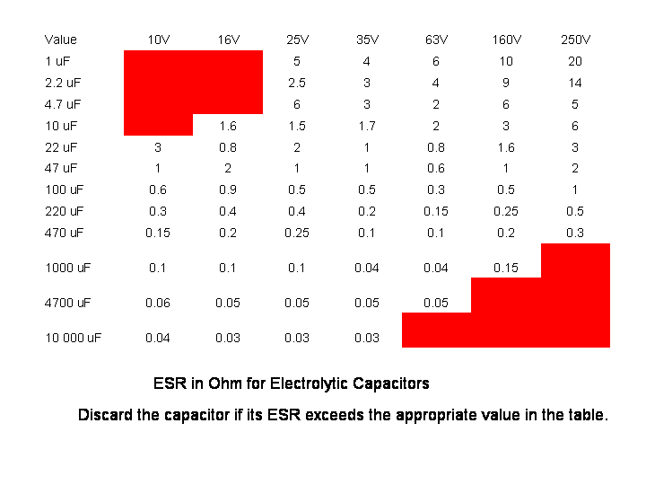

I have attached a table of ESR values. I don't recall where I obtained this info, so it may be a bit out of date now.
Len

The gain is set by the ratio of R11/R10. So if you want 10 times the gain, change R9 & R10 to 270k.
Len
