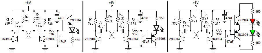

An astable multivibrator using silicon transistors harms the transistors if the supply voltage is more than about 6V which is the absolute max allowed voltage for the reverse emitter-base voltage for a silicon transistor. The emitter-base junctions have avalanche breakdown.
The astable multivibrator circuit charges each capacitor to the supply voltage then when the transistor on the other side conducts, the capacitor forces the base of this transistor to a negative voltage.
Here is a circuit with an explanation:
https://hobby_elec.piclist.com/e_ckt7.htm
Instead of using an opamp that doesn't work at a low supply voltage I have one or two transistors:

Cool man, that 1st one is pretty nice and simple and I have these components.
I think I can guess I couldn't directly feed the 741 because it ended up with triangular waves below 0V... :shock:
Instead of the output transistors that I used, you could use a 741 opamp if it has a higher supply voltage.
The output voltage of the two-transistors multivibrator doesn't go negative, the base voltages of the transistors go negative.

If the collectors have LEDs then the emitter-base junction gets 6.8V with a brand new 9V battery which might be low enough not to cause damage.
When I worked for Philips the first thing I was told was to never allow an emitter-base junction to experience avalanche breakdown because it forms hot spots on the tiny junction that is not supposed to dissipate heat. The hot spots destroy the current gain of the transistor.
In a two-transistors multivibrator the capacitors discharge with fairly high currents into the avalanching junctions.
I found an article that explains it:
http://adsabs.harvard.edu/abs/1976MiRe...15..619M
"The operation of silicon planar transistors under emitter-base avalanche breakdown conditions can cause drastic reductions in current gain. Having investigated the dependence of the degradation rates on avalanche current for two types of n-p-n transistor, the mechanism, carrier injection into the protective oxide is explained, and experimental data from tests on 300 transistors is compared with published theory."
You're right, they were LED flashers so the LEDs dropped the voltage to a safe level.

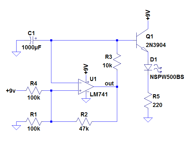

Here's a simple LED fader you can make with one op amp and one transistor, plus a few resistors and a cap.

Okay, I already tried hooking up an astable multivibrator to the opamp using audioguru's suggestion, and it works. but actually, what's that opamp configuration, a negative feedback? The LED fades, but not smoothly.
Also, the one which doesn't involve an opamp (only another 2n3904 + cap) worked too, but the fading is too fast to be seen. (it looks like it's just blinking).
Lets see, I think its called a Integrater. It converts a Square Wave signal to a triangle Wave. You can slow it down by modifying the RC time constant (ie, make either R or C larger). Ive built the one I posted a couple posts back, and its pretty smooth. It basically looks like what the <now> old macs used to do when turned on.
