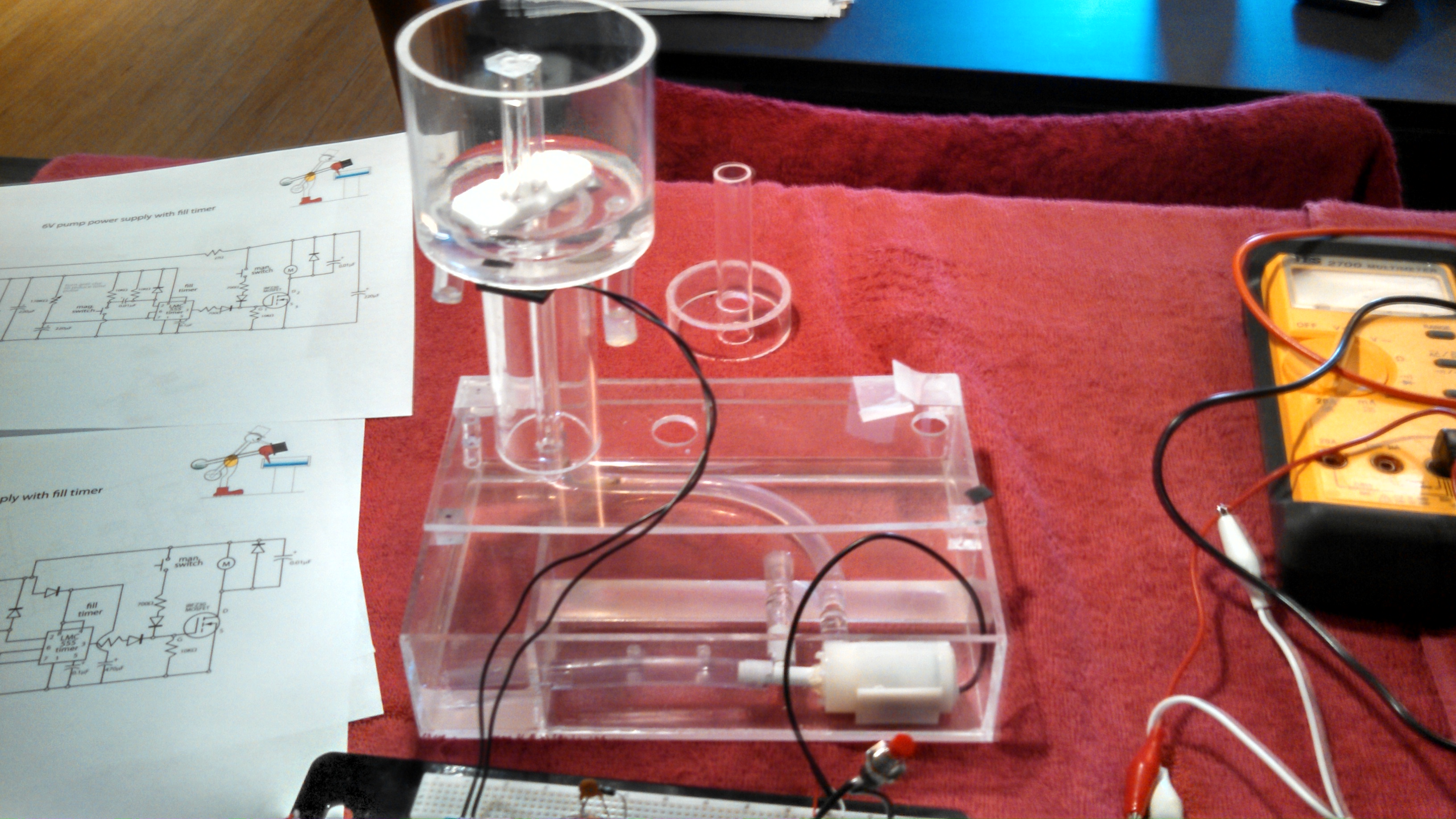

I call the device a dipping bird home. The pump supplies an elevated reservoir (6" high), that slowly fill a lower reservoir by gravity through an orifice in which the bird takes it's dip. When the upper reservoir is empty which takes about a day the magnetic switch will fill up the reservoir. In the picture the lower reservoir is not shown. The dipping bird sits on the bottom reservoir that collects the water. All reservoirs have overflow protection and there is also a priming tube that gets rid of the air in the pump if that were to happen.

But the important problem is that the battery voltage drops so fast that the LM317 regulator does not work.
A 555 is fairly robust - have a biggish cap (1000microF) on that supply side and dispense with the LM317

I'd like to get rid of the LM317 but I can't. The pump can take a maximum of 6V. I could use (4) 1.5V AA batteries but if you add the cases around these batteries I run out of space.
I cannot remember why you are not using a "low dropout" regulator. They regulate 5.0V perfectly when the input has dropped to 5.5V or less. An LM317 set to 5V or ordinary 5V regulator needs a minimum input of 8V.

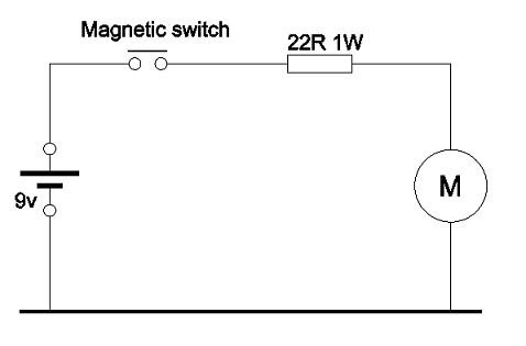

One question springs to mind (now that you have told us the whole story) - why can't you just have the magnetic switch turn on the motor (no electronics necessary)? There would be enough "hysteresis" in the system to pump enough water up to the tank and the circuit would consume zero current when the pump isn't operating (you could add the 27R 1W resistor in series to limit the voltage/current if the battery voltage doesn't drop enough).

First the pump can only run max. 6V, so I need the LM317 because I need a 9v battery. Not sure what you mean by hysteresis in the system, I need the timer so that the pump runs only long enough to fill the upper reservoir because I don't have an upper level detector to turn the pump off.

In answer to the 6v requirement, that is the purpose of the 27R 1W resistor:
R=V/I so =Vbatt-Vmotor/Imotor = 9-6/.15 = 3/.15 = 20 ... (I suggested 27R because I thought you said that the motor was 5v)
so lets choose 20R instead:
W=I x I x R = .15 x .15 x 20 ≈ .0.45W so a 0.5W resistor will handle that easily seeing as how the pump will only be on for a few seconds.
If you raise the magnetic switch (I can't really see it on your picture) to the minimum point at which the dipper thing still works then problem solved - there will always be enough water in the upper tank.
Why make a complicated circuit when a simple one will do?

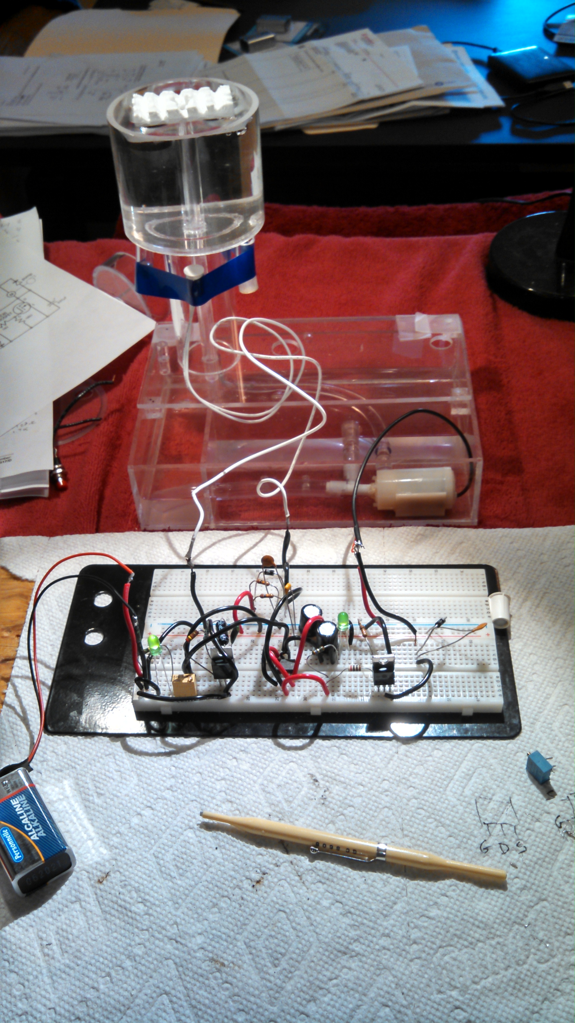

Thanks again for your help and comments. I think you are saying that I could raise the mag. switch to a higher level forcing the pump to stop when the water reaches this high level and start whenever the switch is not activated. This means that the pump will stop and start all the time with only a small movement of the float.
What I want to achieve is that when the reservoir is empty, the magnetic switch provides the signal to start the timer which starts the pump to fill the reservoir. This should occur about once a day. The magnetic switch is located at the bottom of the reservoir, the magnet that triggers it is on a float that rises with the water level.
