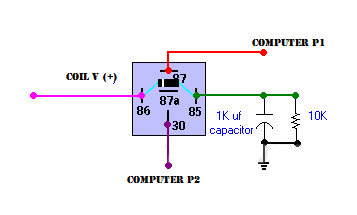

So i have made part of the circuit, This should fire the computer however am am going to have to work out how i can resend the signal when i loose power.
When the relay receives its coil voltage it will open, shorting P1 and P2 on the computer "Turning the pc on"
Once c1 is charged it will close the relay should take 1/2 a second. depending on coil voltage c1 can be changed to get desired output.
R1 will bleed C1 once coil voltage is lost!
Now if i can find away to reverse this i am in luck.

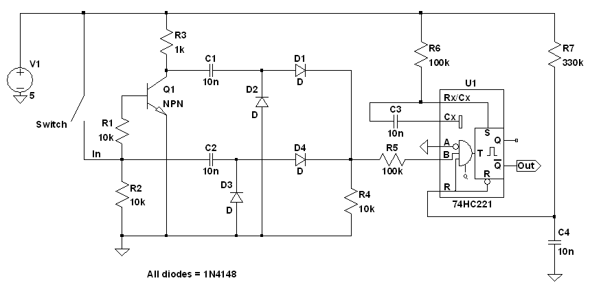

Be that as it may, here's one way to provide a fixed-width negative pulse whenever a SPST (or SPDT) switch changes state. A non-retriggerable monostable IC debounces the switch. You may need to adjust some of the component values to suit your situation, e.g. C3 could be bigger for better debouncing.

Just open the .asc file in LTSpice and click Simulate/Run. The simulation goes very slowly because of the 74HC221 (monostable) model used. If you take the operation of the 74HC221 on trust, just delete R5 and the sim will run much quicker
V2 simulates the input being switched high and low. A positive edge of the input signal provides a positive trigger pulse. A negative edge of the input signal, because of the inverting done by Q1, also provides a positive trigger pulse. The two trigger pulses are 'OR'ed by diodes D1,D4 and fed to the monostable.

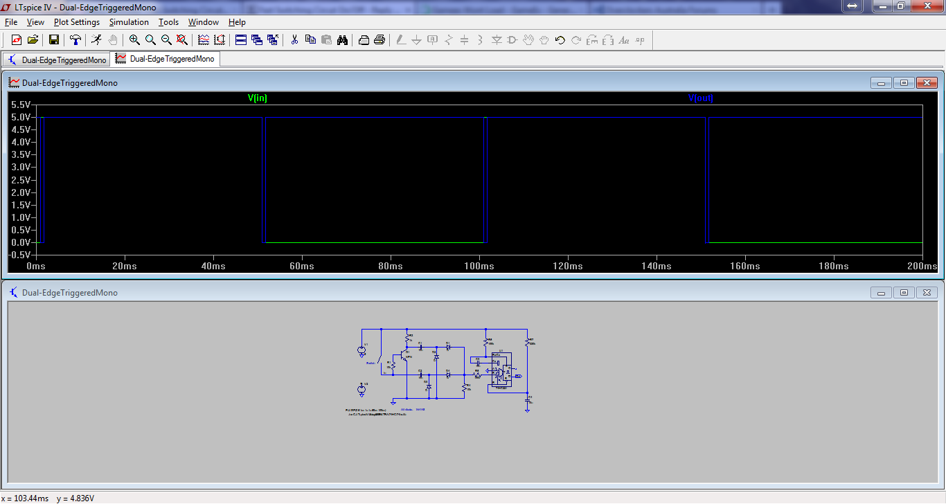

So i had a look at the simulation,
i added a monitor to V2 and V-out.
So i am guessing from what you are saying ("Sorry this simulation is hard to grasp for an old timer")
V2 is the interruption of supply simulating me flicking on and off the switch.
If that is the case from the picture provided it appears that when voltage is applied v out will pulse 5v (if connected to a relay this would open then close) and if voltage then would stay stable.
And then if it was to be interrupted (me turning off the switch) V-out would then pulse 5v again, (if connected to a relay this would open then close).
Am i correct in assuming this? if thats the case this is perfect! if not tell me what i am missing :(

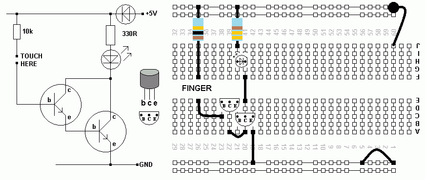

You could use a touch switch of appropriate logic and design, tons of 'em out there. I was considering doing this on my PC because the plastics of the power button jam up every now and then. If it stays jammed when the thing starts to boot up, with the switch still being held down it goes into emergency shut off. This is not good for the hard drive.
I haven't done the mod yet though, other things to do. Instead I just pay more attention to whether it is stuck or not. You may want to analyze your situation too and decide if it's worth it or not for you.
when voltage is applied v out will pulse 5v (if connected to a relay this would open then close) and if voltage then would stay stable. And then if it was to be interrupted (me turning off the switch) V-out would then pulse 5v again
V2 represents the input being switched, by whatever sort of switch you choose, repeatedly to 5V, 0V , 5V, 0V........ The Q output of the monostable produces, at each switching operation, a positive-going pulse output , but if you look closely at the waveform you will see the voltage (which is taken from the Not-Q output) is a negative-going pulse. Either one could be used for relay control, but the Not-Q one should be able to drive the computer switch directly (assuming the supply voltages of the monostable and computer match).
What the circuit can't do, as it stands, is apply to the computer a start-up pulse after a power failure.

If this is true then as I said above, touch switch, all the way.
Not to say that Alec_t's fine circuit won't work, but a variation on one of the below circuits would be (A) simpler, (B) easier, (C) cheaper, and (D) have no moving parts. The disadvantages are that (1) it won't be debounced, and (2) it won't have a programmed timing. But if those things are necessities, they can easily be added. The first is a high side (normally off) switch, and the other is low side (normally on). We have to modify these just a bit for what we are trying to do of course. EDIT: We also need to know the layout of the computers wires of course, to know the polarity.

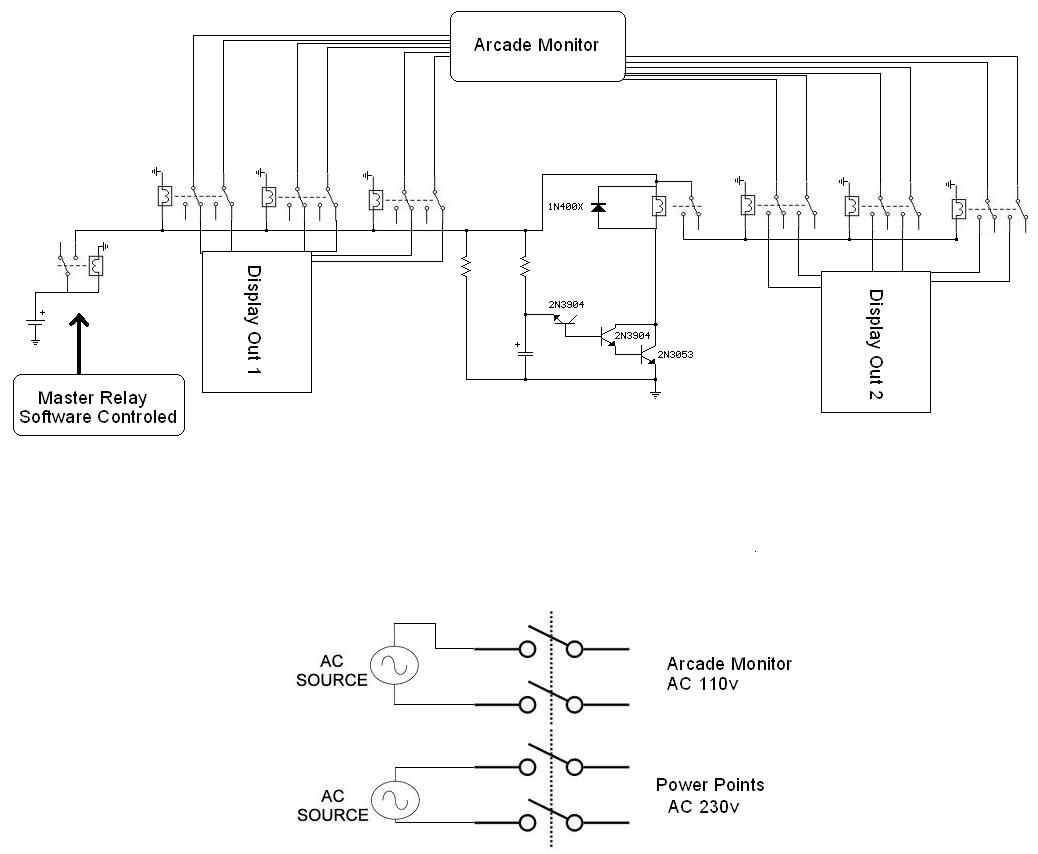

I drew up a schematic in paint, forgive my short cuts for not drawing a complete circuit.... i dislike this program very much!
What took 30 seconds on paper took 1 hour on this stupid paint thing !!!!!!!!!!!!!!!!!!!!!!
Okay let me give you a run down.
This is an Arcade Machine, it has both 110Ac and 230Ac.
The unit is turned on by a single toggle switch, this provides power to the Monitor, PSU (110v) and the Power points (230v) inside the machine only.
From there i need to open the back off it and turn the computer on Via a push button, and if i need to preform configuration changes i need to swap the Monitor cable from Display 1 and Display 2 (marked as Display Out 1 & 2).
I have built a special Master Relay Circuit that when the Computer is booted to a correct state it will notify the relay and open it. (this is a must and needs to be here)
So What i want to achieve.
Adding a way to trigegr a momentary switch when the toggle Switch is turned on and off (starting up and shutting down the pc) ("Please note this is momentary on/off will not work") otherwise i would use 4pst switch.
What the circuit i have designed (not built) will do.
Toggle switch Turns on the monitor. (Manually Start the computer)(I Wante to Eliminate this aswell)
Display 1 (configuration) is active, the default time for this is 1-2 Minutes however if i make any changes this duration will extend (that's why i use the software relay)
When the computer is loaded it will notify the master Relay to Open (sending 5V)
This will trigger the first 3 relays that will disable Display 1.
Then the time-delay circuit will start (Im sure there is a better solution for this part) Perhaps a Capasitor and Resistor for Drain)
This only needs to have a delay for 1-2 Seconds or less (stops 2 displays being conected at once)
Then the Relay will open providing power to the next set of 3 relays that will connected Display out 2 to the monitor.
Now yes i know this all seems pointless however this is what i want to do.
What i am missing is the ability to trigger a momentary switch when the toggle switch is used. (is it possible to connect a touch switch to this? so when i hold the switch to turn it on in-turn it will fire the computer up?)
My other Question is there an IC out there that can do the job of the switching eliminating the need for so many relays?
Thought concerns thanks all !!!

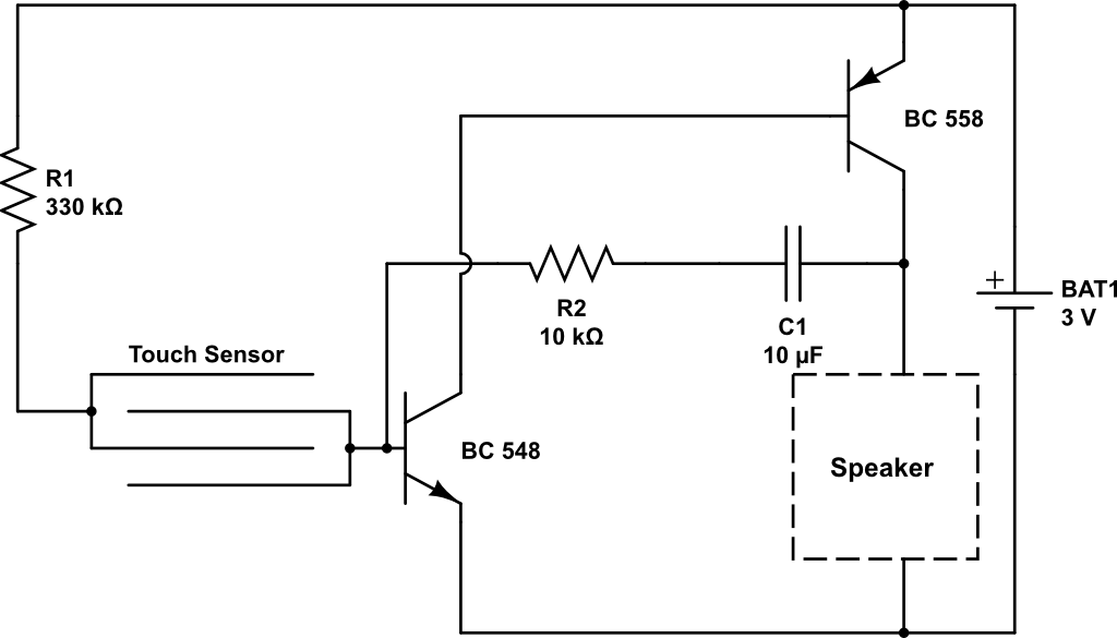

The touch switch that I was talking about is just a way to turn on electronic circuits without the use of moving parts. It is not the same thing as a NR-monostable. However, you can add a touch switch to the input of NR-monostable, and make a NR-monostable that can be turned on without moving parts.
*HOWEVER*... if you have to keep the toggle switch, then you can't really use the touch switch circuit.

Looking at your schematic, I'm guessing that the three pairs of wires running from "Arcade Monitor" to each "display out X" are the video cables RGB, YPbPr, or whatever wires used to sends video to the display?
If I am correct, and you want to essentially make a way to seamlessly switch between the two displays with an IC rather than all those relays, then something similar to the MC14551B (click for datasheet) should work. And if the delay between change is 100% necessarily, we should still be able to do that. I haven't tried it myself though, someone here will have to confirm this idea(IC) is workable. But the datasheet seems to indicate that it was specifically intended for cleanly switching exactly these kinds of analog signals between two devices.
from the datasheet said:
The MC14551B is a digitally−controlled analog switch. This device
implements a 4PDT solid state switch with low ON impedance and
very low OFF Leakage current. Control of analog signals up to the
complete supply voltage range [18v] can be achieved.
If I am wrong on how your circuit works, and those are a bunch of power wires or some kind of high power, or some other thing I haven't even thought of yet, then disregard the whole idea. The MC14551B is only intended for "signals", it can not carry power like a relay can.

How high quality is the video going to the screens? Since you are using relays and it is working fine, then I assume it's not that extreme. It's probably normal VGA, or SVGA at best right?
If the signals the relays are switching are in fact high quality video, then the MAX4137-MAX4138 would be a better fit. The bandwidth for the better graphics standards can get quite high, and the MC14551 is not really designed for such extremes. On the other hand the MAX4137-MAX4138 were made specifically for switching high bandwidth video from one display to another. You couldn't find a better fit.
However...
We are starting to get in the area of high frequency analog, and that gets crazy hard to do without a good printed PCB. The datasheet for the MAX4137-MAX413 recommends you use "Microstrip and Stripline techniques" and you "design the board for a frequency greater than 1GHz." This is a tall order to DIY. Hopefully your video quality standards don't require this kind of design.
And yes... you will need more than one of either chip no matter what you do. Two of the MC14551, and three of the MAX4137-MAX4138. The sync signals are slow enough that they can probably work with the MC14551, so you would need to still get some of them to go with the maximum chips.
