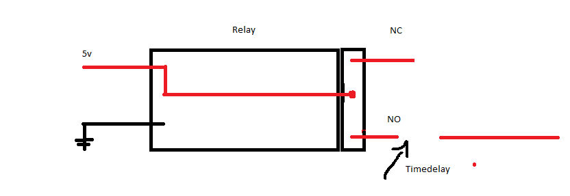

The one issue i have is i need to make a small delay on this relay when it switches, so it interrupts the 5v supply.
iv drawn a small diagram to show you what i mean.
so i believe i have created a time delay circuit.
I will build it tomorrow when i get a chance but does this look right everyone???
Close, but it simulates the opposite of what you want I think. The relay is on as soon as power is on, then shuts off after the delay is over. Is this really what you want? If so, leave it, works wonderfully. Otherwise, take out the transistor, reduce the resistor to like... 100-500 ohms... hook that to the relay coil, and the other end of the relay to ground.
Also, no matter what you do, don't forget to add a reverse polarity diode to the coil terminals of the relay, this stops HV inductive kickback from destroying your transistor/555 timer. You will be sorry if you don't add this.

Actually, the trimpot and the capacitor in the top left don't really do anything. You can just remove them, then make the 1M resistor a 500K trimpot, or use a 250K trimpot and a 250K resistor in series for about the same effect. Also, the 10K resistor on the transistor is too high, use 1K instead. If you don't use enough current to turn on the transistor, it will only be partly on and will overheat.
hahah yes you are 100% right, well i got it majority of the way there thanks for poiting out the pot being in the wrong place *facepalm*
Yes the circut is now 100% the opposite of what i want, what components do i need to move to make it the other way, i tried removing the npn and all that does is allows a positive charge (like what i want) but only for x number of seconds.
Ah i think i know what i need to do replace the npn with a pnp and it will reverse!!!! it will be off !! i will test tomorrow!
Don't actually hook it to ground, hook the other end of the relay to the positive, this will make it off until the delay is over. The other way around will bring you back to where you started again.
Explanation.
Pin 3 of the NE555 timer IC can both sink(short to ground) and source(short to +) up too ~200mA of current. This is quite a lot for such a little chip and should be more than enough to drive the average relay coil. So you really shouldn't need any buffer transistors, though there are some relays out there that could easily exceed 200mA, but I don't think yours does.
More importantly, the sinking and sourcing on pin 3 allows you to easily invert it's output, by letting it drive to either positive or drive to ground. This can be done by just hooking the other end of the load to the opposite power rail. In your case, you want one terminal connected to the positive, and the other to pin 3. If you hook one end to pin 3, and the other to ground, it will be on for the delay, then shut off.
Moving on, the timer part of the circuit works by slowly charging the 10μF capacitor through the 1M resistor. Threshold (pin 6) is constantly watching the voltage between the cap and resistor, and will change it's (Edit: The 555's) output whenever the voltage matches the voltage on pin 5, which is about 2/3rds (~66%) of Vin. The lower the resistance of the 1M resistor, the faster the 10μF cap charges up to 2/3rds Vin, and thus the faster the timer will run out. The lower the voltage on pin 5, the sooner it will trip also.
In this configuration, the NE555 is really only working as a Schmidt trigger/comparator buffer for the RC delay circuit. This effect could be achieved many many other ways, but since you already have it started, you should probably just keep going with it. The circuit will work nonetheless.
Click *HERE* for a simulation of the circuit. The pin numbers are right next to the 555. The trimpots resistance can be changer with the slider on the right. Resetting the simulation with the button at the top right will let you see how long it takes for the timer to run out and the circuit to trip. The time taken is at the bottom of the schematic.

Sorry, your circuit is still not quite right I'm afraid... :(
First off, you really need to remove the 0.1μF cap and resistor in the top left. Those parts, in that configuration, have the effect of holding pin 2 at Vin voltage level. Well... pin 2 is the "trigger" input, and without going into too much detail, holding it up like that forces the output pin (pin 3) to ground. In other words, as soon as power is applied to the circuit, the relay will activate, regardless of where you have the trimmer pot. This is clearly not what you are wanting. If you plan to do anything with pin 2, you should just use the 10K to tie it down to ground, not to Vin.
Second, D1 will block pin 3 from being able to turn on the relay, so it needs to be removed. If you have a compelling reason why you added it, I would love to hear it? It won't stop high voltages from entering the 555 if that's what you were after. Most "normal diodes" break down at 50~200 Volts, and a HV inductive kick from the coil can easily get into the thousands of volts range. D2 is enough to stop the coil kick back voltages from getting large enough to destroy the chip. For more sensitive chips though it wouldn't be enough, and you would need to use an "ultrafast", Schottky diode for D2, or proper RC snubber along with it. But the 555 is anything but sensitive, so such things are unneeded.
Thirdly, pin 7 is the "discharge" pin, and is only used in astable modes. It has the effect of resetting the timer by discharging the timing capacitor. Pin 7 isn't going to work without the trigger hooked up, but if it did work like it is supposed to, what would end up happening is it would shut your relay back off after a second time delay. This is also not what you want. You CAN leave it hooked up, since it's not going to do what it is intended for. But this could lead to glitches later on down the road. It won't hurt anything to just let it float though, the pin is not used for your configuration.
Lastly, it looks like you are trying to make it so every pin on the chip is being used? Normally this would be a good thing, many IC's can be damaged if you don't do something with specific pin types. But the 555 is a very odd duck, and doesn't really have this requirement. It won't break anything, but you don't need to be doing it either. This is mainly only needed with digital IC's, but the 555 is an analog part. If you absolutely have to do something with every single pin, tie both pin 2 and pin 7 to ground with a 10K resistor. That's the best thing you could do to keep all the pins used up. Again, you don't need to do anything, you can leave them floating.
Everything else is correct, and changing the values of the timing cap and trimmer resistor is also OK. One thing, if you want a specific minimum time, you will need to add a fixed resistor in series with the 10K trimmer. The trimmer can go all the way down to 0 ohms, this in theory will make the timing cap charge instantly and the output pin turn on instantly. So if you want to make it so that you can't set the time to less than ~0.5 seconds, like you have ion your drawing, then you will want to add a 1K fixed resistor in there also. It doesn't matter if it's on the top or bottom of the trimmer, it will have the same effect.
hrm the circuit will not work with those changes.
However the only change i can seem to make is pin 7 i can remove that and it works like a treat.
ill remove D1 no idea why i put that there
