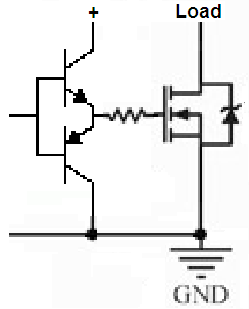

Hayato, Is this what you meant by BJT totem? Both FETs would be turned on.
Thanks,
Kinarfi

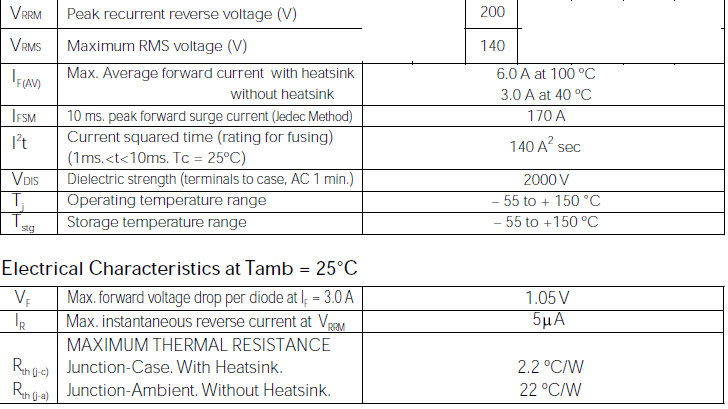

The diode across an inductor that clamps the voltage spike produced must conduct the current that the inductor was passing. If the motor instantaneously reverses then the current might be 200A! Your low power rectifier bridge was useless.
A complementary pair of emitter-followers can quickly turn a Mosfet on and off.
EDIT: Maybe the peak current rating of your rectifier bridge was good.

Here's the specs on my bridge rectifier, being as it's only active for a split second, the 170 rating should suffice and the motor can't be "instantaneously" reversed, it has to go from forward to zero to reverse and zero is dynamic braking and I plan to put a 50 amp transducer in the works to turn all H bridge FETs off simultaneously. I'll look into your drawing.

Hi.
Audioguru posted a schematic on post #44.
Don't forget that the resistor connected to the MOSFET's gate is a low value, from 10 ohms to 47 ohms.

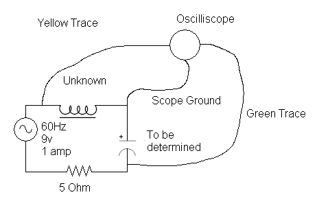

If you have a scope with dual inputs, the waveform at resonance across the capacitor and inductor will be out of phase 180 deg as they cancel to form your low impedance "short".
Isn't easier just to measure across the inductor in series with a resistor?
You know your Vpp, frequency and resistor.
With an scope:
And you know that the total impedance is R + j*2*pi*L. And the voltage across the resistor is Vp*R/(R+j*2*pi*L).

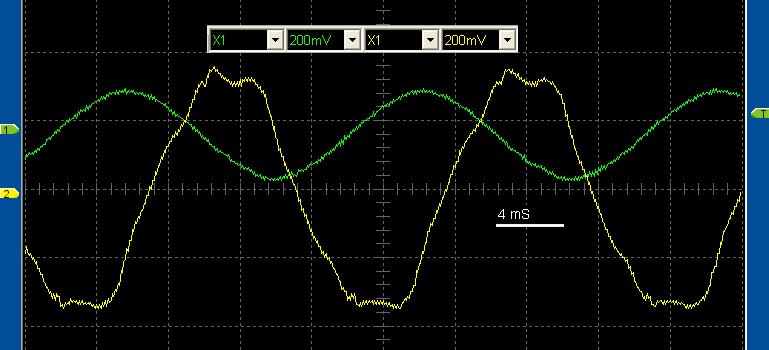

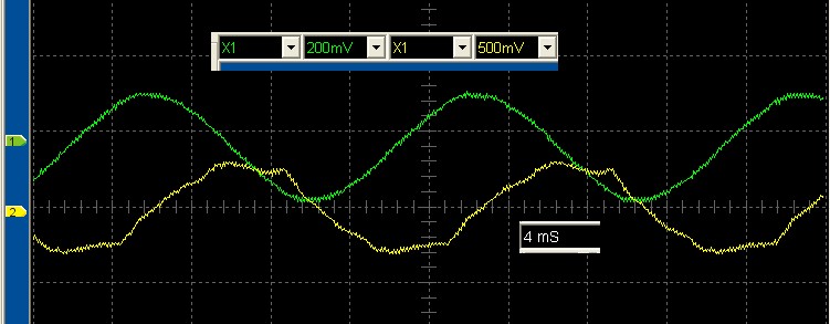

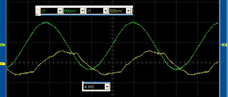

Don't have a variable frequency sine wave generator so here's what I did :eek: and it sorta worked, I gathered up every cap I had, got a 120 to 9 wallrat, took the diodes out, hooked one side to 5 ohms 50 watts resistor, other side to a motor lead, resistor to a strip of metal other motor lead to another strip of metal, both L shaped and started laying capacitors across the metal strips. After I got all of my caps in the circuit and saved the trace, I started to measure the combined capacitance and since I hadn't paid any attention to polarization of the caps, it would measure. It was fun though, even if it was a waste of time. Guess I'll build a sine wave generator. Oh yea, Green trace is caps, yellow motor.

you were half way there.... 90 degree phase shift..... the resistor idea sounds good, except the winding resistance is going to skew the results.
Don't forget that a 90º shifts fits only for a ideal inductor/capacitor.
Specially for a inductor you have:
phase = Arctan ( wL/Rwinding).
Of course, it will be ~90° due the low ohmic resistance from the windings.
You could just use the 9V from wallwart adapter transformer, w/o any caps. The transformer will supply a 50 / 60 Hz sine wave with a 12.72 Vp.
