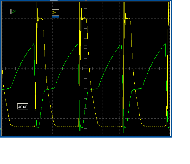

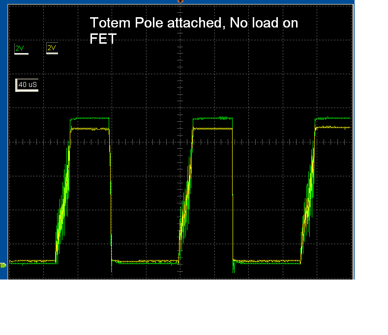

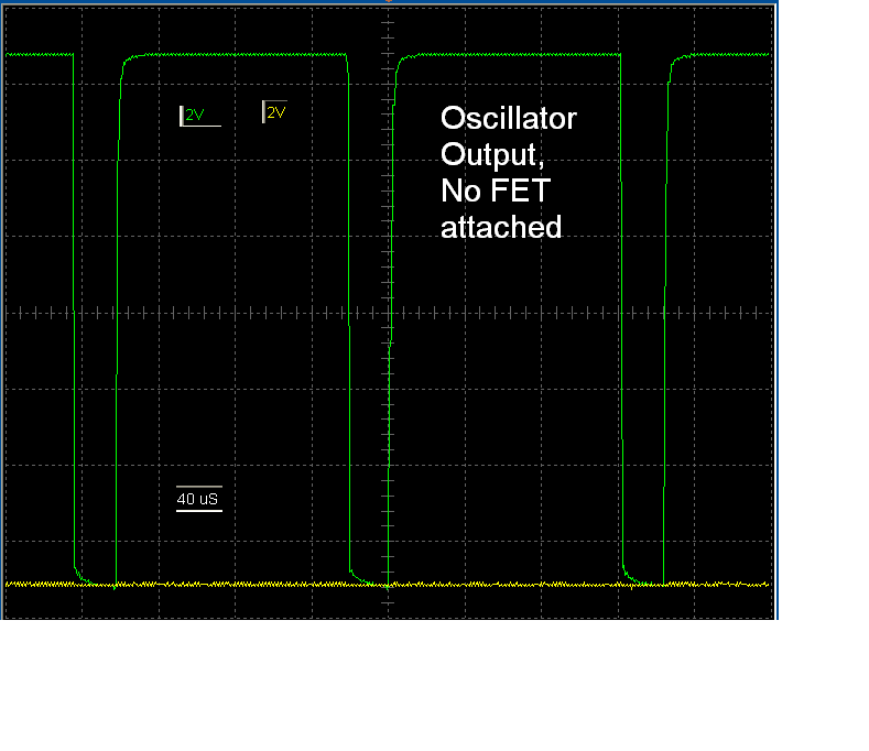

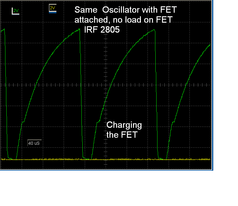

I have been redoing my design and incorporating some of the stuff from this forum, I have several screen shots from my scope and found it educational, for me at least. Some of the shots have text inserted. My attempt to use a totem pole didn't seem to work at all, I used a 2n4401 & 2n4403 and it didn't work, maybe I messed up the hook up because I think at least one of them was in a TO-92-18R package, same as TO92 but EBC instead of CBE, I think. Try again tomorrow.

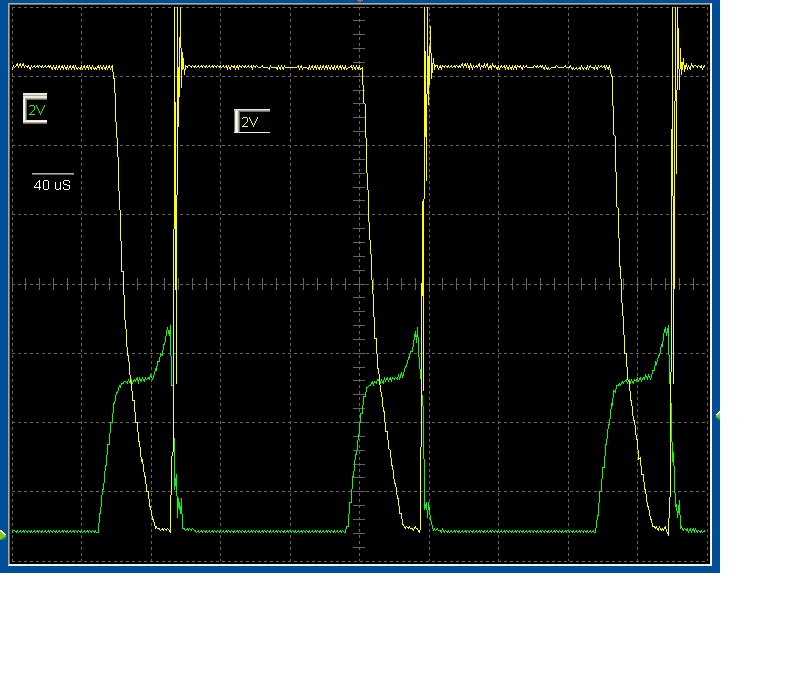

Any way, It was interesting to see how the capacitance of the FET effected the oscillator output, and you could see the turn on time where the FET was linear.
One thought about using a higher frequency for PWM versus low frequency PWM is that the FET goes linear 6000 times a second at 6Khz and only 100 time at 100 Hz which is 1/60 the heat from being linear and if you use ultrasonic frequencies, it would be even worse. When you think about it, in the USA, we have 60 Hz electrical power, 120 pulses / sec, so 100 Hz PWM seems like it may be OK.
on the last two, the yellow trace is the FET, high is off
2 cents
Kinarfi

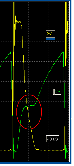

the ramping of the signal going to the gate is because of a high impedance output from whatever you're using to drive the FET. with a low output impedance (such as using a buffer amplifier), the ramping effect will be minimized, and the FET can be driven with higher frequencies (remember to stay below the dv/dt of the gate)
Are you still using an LM339? It is low power so its outputs cannot go high with enough current to quickly charge the capacitance of the gates. Its outputs go low fairly quickly as shown in your ramping.
All the 2N4401 and 2N4403 transistors that I have seen use the American pins of EBC. Yours didn't work maybe because the pullup resistor for the outputs of the LM339 were missing.
The 10 ohms resistors in series with the gates prevent the Mosfets from oscillating . It should be mounted very close to the gate pin to minimize inductance in series with the gate.

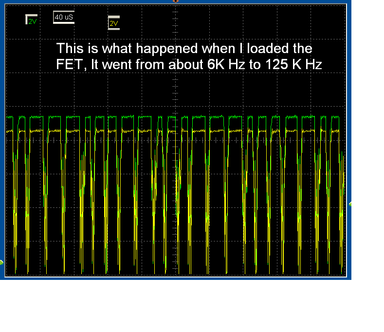

Hayato; I haven't used the motor as a load yet, when I do, I will have a 100 ohm, 10nf snubber across the leads.
I found the scope shots interesting, especially the circled area in this one. I notice the wave form changed very little with load, and the FET did get warm to the touch with the 2 ohm resistor, it was heat sinked at the edge of a 3/16 aluminum plate with about 1/2 the body in free air, but it did cool quickly when turned off.

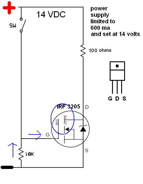

"In the bottom left corner is an N FET drawing similar to what I had when I Killed my FETs, minus the cap. I figured there was something weird going on and the dv/dt sounds correct, I was suspecting that the gate was charging backwards (blue circle) when off and when the switch was closed, it discharged and recharged 'violently' punching a hole in the gate insulator and killing the FET.
originally attributed to noise, dv/dt makes real good sense to me. I reverse charged the gate with a diode checker and got conduction in one direction only, doing so with the power of closing a switch to, or touching a wire to, the gate would create a high dv/dt, considering dt is extremely small.
I guess I just believe that it was dv/dt that killed a couple of high power FETs when current was limited to < 1 amp! and no, I haven't been able to find any specs about dv/dt on the data sheet.

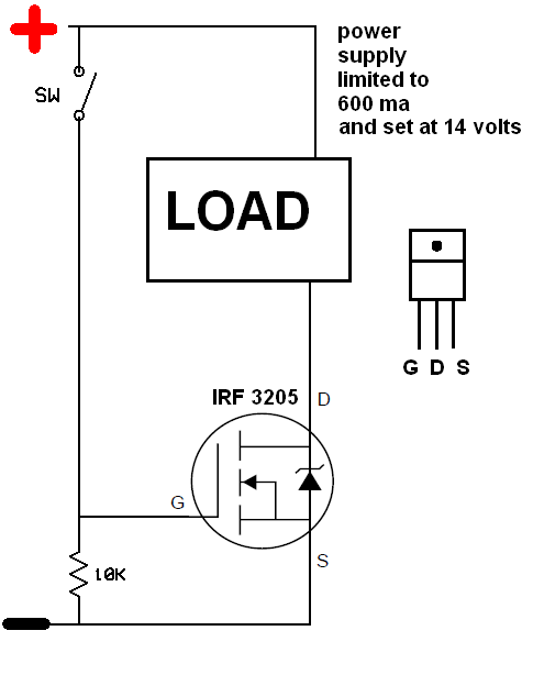

I ask as nicely as I can, would you please build the circuit referred to in previous post without the cap and attached and try it, see if you lose power FET also or not? and let me/us know. Remember, it's the closing of the switch after the gate has reversed charged that kills the FET. Good Luck.
Kinarfi

The attached drawing is exactly what I had, the switch was a mini clip and the load was a test light which draws about 150 ma. If you build the circuit using a 100 ohm resistor, and use an on/off switch or just touch wires together, you will prove a point, I don't know which point, but if the FET dies, that's one point, if the FET lives and works, that's the other point.
This is my guess as to what happens, with the switch open, a reverse charge builds up on the gate as shown in the attached drawing, maybe there should be a bunch more + in other areas, I DON'T KNOW, then when the switch is closed and the gate charge is drained off and the polarity of the gate charge is reversed, the fragile insulation is damaged because it happened so fast and the FET dies.
This is purely a guess, and I have only my own reasoning to pull from.
I don't want to throw challenges out, but if you are correct. building and trying the circuit can't hurt.
Kinarfi

I'm looking to the last picture link you posted.
There is a useless IRF2805, with the Drain connected to the GND and the Source connected to 0V, and the Gate connected to a ON/OFF switch. This FET is not working. It is just a high resistance piece of silicon.
The output driver is driving a NFET and PFET at the same time with a 2.5k (2 5k in //) resistor at the OC output. I do not feel confortable with it.
Why not use the 339 to drive a Totem Pole?
