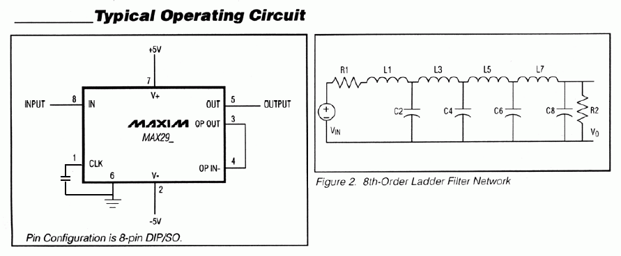

A switched-cap low-pass-filter IC like the ones from Maxim have slopes up to 48dB/octave which is the equivalent to having 4 LC stages or 8 buffered RC stages. You can easily change the cutoff frequency.

I used National Semi's similar switch-cap filter ICs many times. They are easy to use and work very well. National doesn't make theirs anymore.
They filter so well you can feed a square-wave in and a pure sine wave without any harmonics comes out.

The 8th order Butterworth switched cap filter IC that I recommended is like a brick wall, it removes noise and distortion above its cutoff frequency very well.

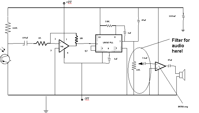

My application
I want to use the Switched cap filter to pass anything below 5khz to the audio amp. The MAX291 seems ok here -My design is for an optical intercom it is FM with about 40Khz carrier. At RX end the PLL demodulates I want to filter afterwards - its quite nosiy at the moment. Also I can send music OK for say 2m (currently with low power Ir LED's) but if I plug in a MIC at the TX I can't get anything im figuring I need a MIC amp of some sort, only if I shout into it do i get some kind of response at the RX - Any idea's??

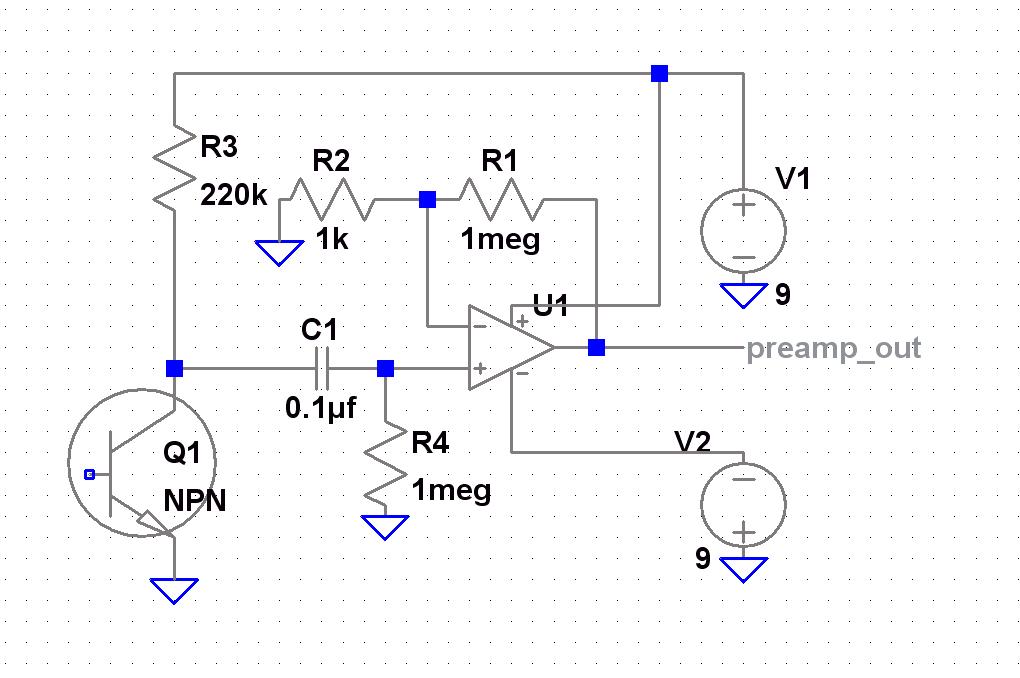

The 1K input to the op amp is attenuating the signal, try this circuit which has 1 meg input resistance.

Hi Russ,
Ouch, ouch and ouch again! What are you doing with a DC and AC gain of (gasp!) 1001? You don't need nearly so much gain unless you were trying to pickup IR reflections off the moon!
Just think about how noisy the signal will be, if the opamp even had an output. If the opamp has an input offset voltage of only 6mV, its output would be at 6V. Plus the input bias current difference beween one input with a 1K resistor and the other with 1M. I am sorry but your circuit will probably rectify the loudest sounds or its own noise and not pass the others.
Add a cap from the 1K resistor to ground and the opamp will be biased correctly and might make a pretty good FM limiter to reduce the noise, but won't have much gain with an ultrasonic carrier.
I agree with you that the old 741 is too noisy for audio.
Let's concentrate on the LM565 circuit. It has huge caps so its VCO is tuned for a 40Hz carrier! A bit too low. I think that even 40KHz is a poor choice, beware of anyone pointing a TV remote at it. The LM565 circuit also has a huge cap across its output.

I think the original circuit has a gain of only about 9. The collector of the transistor is a fairly high impedance current sink, maybe exactly 220K at times. I think the circuit will work about the same with the 1K resistor bypassed.
ok what does this mean guys!!!!
Russ in the circuit you drew what is the purpose of R4 is to filter the input if so why does it have a cut off of 1.5Hz? How do you guys suggest that I connect up the input- Will it help to use a switched cap filter IC??
Thanks for all the help
The opamp input has to have a DC path to ground, that is the only purpose of R4. C1 is a DC block, you can set the cutoff frequency wherever.
If you make R1 100K, the circuit should work, even with 741 but please try a better op amp. SSM2135 from Analog Devices is low noise.

Russ admitted that his design had errors. The purpose of its R4 is to provide a 0V reference voltage for the opamp. Without R4 the DC output voltage could be anywhere and cause severe distortion.
The input capacitors of each circuit have a value much too high for a 40KHz FM system.
I bet your noise is coming from the noisy old 741 opamp. And I bet you have another one in your transmitter. Use low-noise audio opamps like TL071 instead.
Are you actually using 1uF caps in the LM565 circuit and a 47uF cap across its output as shown on your schematic? Haven't you seen the datasheet and the link to the application note I posted? The values of your caps are about 1000 times too high for a 40KHz FM system.
I just realized that the high level of the 40KHz carrier at the output of the LM565 could messup a switched cap filter and your LM386 output amp.

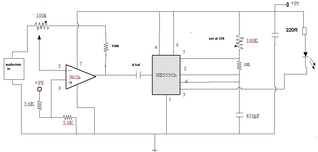

Mic problems/LM565 values/noise/hissing
Sorry my diagram was incorrect im using 3.8k 2nf cap by the oscillator
frequency formula f0 = 1/(3.7CoRo) its abut 35Khz and I matched
that to the TX output.
My issue was regarding the fact that when I input audio (a walkman etc) into the transmmiter I get an output from the RX at about say 2m at
the moment its noisy (in terms of hissing) but it works.
Now when i attach a microphone (not powerred to the transmitter I get
nothing by speaking when I shout I hear something though its
completely unrecognisable against the hissing if I turn up the gain I just get more noise + distorsion!!!
Its for an intercom. The diagram below is the TX and the previous one is the RX there will be one of each on both sides.
Im guessing mic can't supply enough power the problem is I
don't really want to use a powered mic because I want the user to be able to plug in their own headset.
Russ/Audioguru I have the TL071 op amp will this have lower noise???- I want to increase the gain from the MIC but im also increasing the noise/hissing also which i dont want.
Also Im assuming (though im not too sure why!!) that if the system/design can transmit audio, as in music, it can definately
work for voice communications without too many modifications.
Is that a reasonable assumption or have a got to go back to the drawing board.??

Yes, the TL071 is low noise. The circuit should work OK for voice. I would put a 75 ohm resistor in series with the LED to limit the current, the current output of the 555 is not well controlled but is at least 200 mA.
Hi Electricman,
Thanks for posting corrections to your schematic and its important details.

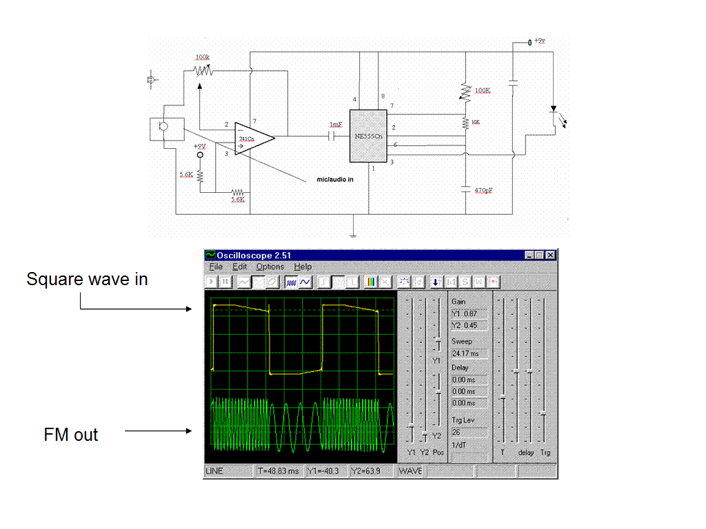

I was right! You are using a noisy old 741 opamp as a mic preamp. Of course a TL071 will be much, much better.
It looks like you are using an electret type of microphone, its terminals might be backwards and they don't have much output when backwards.
The schematic shows a two-wire mic, but the icon shows a completely different 3-wire mic. You must be certain which type of mic the users will have or maybe have a separate circuit and input jack for each type. They might not even be electret mics and need a different circuit again!
The mic preamp circuit looks odd:
1) When you turn the volume up, part of the volume control loads-down the mic, reducing its output. The other part of the volume control increases the gain and noise of the opamp. Low sound and high noise!
2) As you turn the volume up, it isn't capacitor-coupled so it messes-up the biasing of the opamp, causing horrible distortion!
3) The load/powering resistor for the mic is the variable volume control so it is correct at only one setting, where the gain and biasing won't be correct.
4) The center-supply voltage reference of the opamp at its pin 3 doesn't have a filter cap so will be noisy, especially with a 555 high-current driver on the same battery supply!
The FM modulator is a 555 high-current driver. Its supply decoupling capacitor isn't detailed and might not be big enough to filter its 400mA supply current transients it produces when switching. The transients feed directly into the mic preamp's input. I recommend having a separate resistor-capacitor supply decoupling network for the mic and preamp.
The 555 might be operating with a 10% duty-cycle which must be very confusing for the LM565 PLL. I recommend re-calculating its timing parts so its output is close to a 50-50 square-wave.

Hi guys my previous schemeatic was not quite accurate- I posted the new one. Anyway ive changed the Reciever op amp to a TL074. When the TX variable is set to 37K that corresponds to 53.75Khz by(1.44/(Ra+2Rb)*C) with an audio input I get a good quality audio (music) with little noise att the output. The PLL has (with 3.8K and 2nF cap ) has a centre frequency of 35Khz which makes me suspicious though. This is for the IR RX and TX Led's no more than 10cm apart- After that I lose signal strength, but now im pretty sure the electronic noise problem is sort of under control. The noise I get whilst moving the Tx and Rx apart I think is mainly from optical sources from the environment become more predominant as he incident flux (IR) on the RX diminshes with distance .. the hissing decreases significantly as i dim the lights!!!- I plan to use better IR phototransistors with much less suceptibility to ambient light.
Audioguru - I want to test with a 2 terminal electret mic which is what I a have not sure how to use the thing though. Anyway ill carry on testing with audio for the moment.
The problem is I need a range of at least 5m with this system. At the moment Im using vary basic TX and RX infra red LED's. Nowadays there are some great emmiters about which can take a 1A in pulsed operation they should eaasily be able to provide the power I need(I hope). but the duty cylce must be low or you will burn out the devices.
It says the 555 can sink 600mA I think this should be enough except Im not sure how to control the current output at pin 3. Do any of you guys know how i can make a high current driver to drive an array of transmitter LED's (maybe 3-4) from the output of the 555????
You mentioned about the getting a 50-50 square wave-Is this the mark/space ratio??
