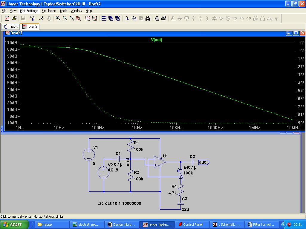

simultion of mic circuit
Hi i simulated the mic input in LT SwitcherCAD3 using the mic as an AC 0.5V source and performed an ac analysis from 1-10Mhz to see the frequency response. This is what i got, Is this what it should look like???
thanks
Hi Electricman,
Your sim shows the open-loop gain and frequency response of the opamp without feedback and without the caps. As they usually do, your sim screwed-up! :lol: :lol: :lol: :lol:

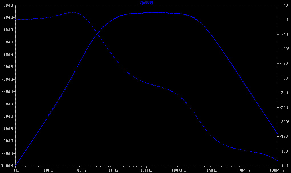

frequency response
Do you think this frequecny response is ok for the amp cct you suggested for the receiver (using 2 opamps), the opamp parameters are probably not exactly the same as the TL071/2 but it seems ok.
thanks
Hi Electricman,
The frequency response of -3dB from 1200Hz to 270kHz is fine for your FM modulated IR link and its 38kHz carrier.
Where's the 61dB of gain?
