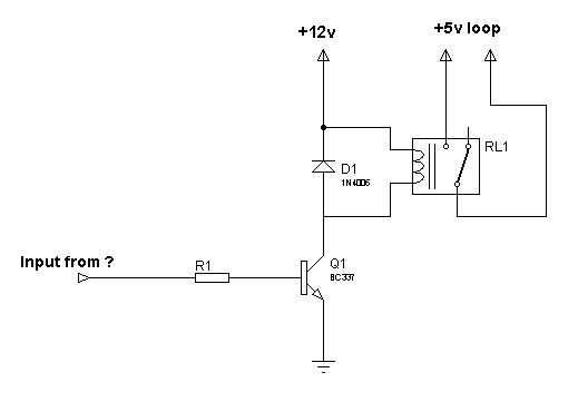

As MikeMI mentions, your description is a little difficult - however it might be better if you can do a small diagram so we can see what your really mean.
Have just done a relay section from your description thats suitable for one of the many cheap little PCB DIL type relays.

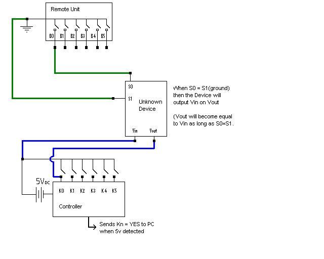

that diagram looks like what I'm trying to do, but just to be sure, here is my attempt at diagramming "what I'm trying to do."
Forgive me for its crudeness, I am at work and only have paint to draw with.
Obviously this only shows for one button and one input. I can't change the arrangement of either the Remote or Controller. Consider them black boxes.
This will be running in a car, so if the device requires a voltage to operate, I have 12v to power it.
I was hoping to find a "device" like I show, but I don't mind putting together components (diodes, resistors, transistors, etc) to build such a device myself, but I am so out of practice I would need values and even better model numbers.

What is the voltage between S1 and S0 when an input switch is open? (edit: I guess we can define this, right?)
Can the Ground (S1) be tied to the ground on the PC?
But that diagram you have drawn will send 0V when the switch is pressed, because Vin is connected to the negative side of the battery. I thought you wanted to send 5V when the switch is pressed?
1y5zdzjy, it looks to me that your diagram is exactly what I'm trying to do, except I could use the 5v off of the controller instead of using a 7805 to downgrade the 12v (essentially ignoring my statement of having 12v as an external power supply).
To make sure I'm understanding. The Transistor wont allow the 5v to pass to controller, unless there is closed circuit to ground (via the switch). Am I understanding that right?

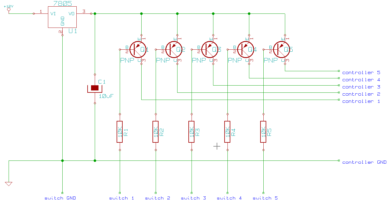

...check this one out
You didn't answer the question if the ground symbol on your drawing is tied to the ground on the PC interface?
fantastic, that is it. I appreciate the help. What kind/model number transistors should I order (or a single IC with 5 or more transistors), and whats the best place to order in small quantities.
If you can tie gnd together on the switch and the controller this will do what you want:...
It might work most of the time :D
Good engineering practice requires five additional resistors from each PNP base to +5V to guarantee that the PNPs will turn off. Additionally, your circuit makes a big assumption that there is a pull-down resistor on each of the inputs to the PC interface, so that the input signal is at a defined "LOW" when the PNP transistor is off. If that pull-down resistor is not there, you would have to add five more resistors, so we are up to 15 resistors, 5 transistors.
I would use five channels (out of six) of a CD4069 CMOS hex inverter. Put a 4.7K pullup resistor (other end tied to +5V) on each switch/each inverter input. Power the inverter package on +5V. Wire the five inverter outputs to the five inputs on your PC interface. This requires five resistors and one hex inverter.
That is incorrect.
Yes it does make that assumption, based on what dranobob said "When 5v dc is applied to an input, the controller sends a signal to the software in the computer."
2N3906 (TO92) or FMMT591 (SOT-23) will both work for the transistors.
