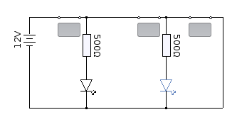

Based on my Honors Physics class lessons on circuits (about 5 days), I drew up a schematic and bought the necessary parts. However, upon putting them together nothing happened.
I've attached the schematic. The first switch is a shielded toggle switch like in a cool movie device. The second is a push-to-trigger button. The third wire is where the fireworks are attached. Normally, the firework would receive no current until the button is pressed, at which point it will receive nearly all the current. The only problem is that I do not have a 12V power source and don't feel like strapping 8 AA's together.
Thus, in scaling down the circuit, I came up with the equation that my resistors would need to be ~150 Ohms.

When I put my circuit together with 1 560 Ohm resistor and 1 2.6 V LED, the LED did not light up. Is this because the resistance is too high? Because I also connected another LED of the same kind, and it too did not light.
So in conclusion:
  • Is 560 Ohm too much for 3V?
  • Is 20 mA enought to ignite a firework (with 20 gauge stranded hook-up wire)

If your LED is really 2.6V and if your battery is really 3.0V then the 560 ohm resistor has 0.4V across it and therefore the current is only 0.7mA. The LED should light very dimly.
With only 3V from two little AA cells, the 20 gauge wire is a dead short and will kill the battery very quickly before anything gets hot. You need many Amps of current in the 20gauge wire for it to get hot enough to ignite fireworks. A 12V lead-acid car or motorcycle battery could do it.
Hmm... So if I do go for the 12V, would the 560 Ohm resistors be sufficient, or would I be better off getting lower-resistance ones?

Alright, now I know I've done something wrong. I purchased several small 12v remote batteries. I hooked one of those up in series with a 560 ohm resistor and an LED, and nothing happened. I tried it again with a brand new LED and a brand new resistor, and...nothing happened.

Why scribble a schematic in text? Draw the circuit properly!
The battery and the LED have polarity. If one is backwards then the LED won't light.
Make it like this:

If the LED came from a grab bag, it may be invisible IR.

If I were to place the LED backwards with the resistor, would that blow it out? Also, if I were to blow out an LED, would there be some visible damage (IE way to know it's dead)?
Also, (came to me last night) should I be using a larger capacity battery? I am currently using tiny (smaller than AAA) 12V keyless remote batteries. I was wondering if I should go out and get like a 12V lantern battery.
Instead of guessing about batteries, go to a manufacture's website and look at the datasheets.
Energizer's largest 12V tiny "remote" alkaline battery, the A23, is rated for only 480uA.
Your LED with the 560 ohm resistor needs 17.9mA which is 37 times higher.
I think the LED should have lighted dimly for a few seconds if the battery was brand new.
Yep, that figures. If I had had an ounce of sense in the store, I would have gone for the bigger battery right off the bat. And while I'm at it, I may just pick up a voltmeter. Thanks for your help.
