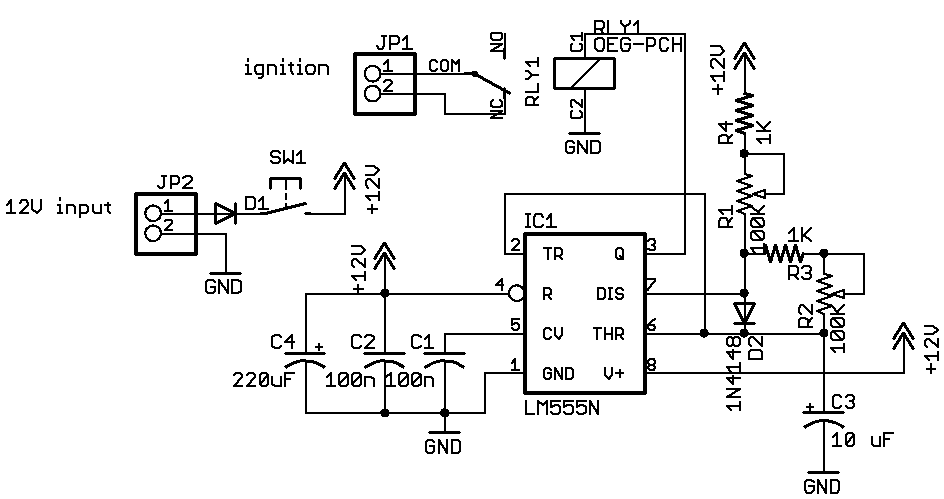

this is close to what you want. sorry for the semi-ugly schematic. I've never figured out to draw clean ones using the 555. I set up the relay to break the connection but you can do what you want there. Pulse width and frequency are adjustable. I didn't know how clean your 12V source is so I added a 220uF and 100nF caps. I put a diode in series with the 12V source to protect against battery reversal. R1 controls pulse width, R2 controls frequency. I'd use small trimmer pots. R3 and R4 are optional but are there to avoid running the trimmers to 0. I would find a sealed 12V relay with coil current below 50 mA or so. The switch simply switches power to the unit so it is only drawing current when you use it.
On the relay, you should not switch the ignition coil current.

Ok, I really do appreciate your drawing. I'm trying to learn the notation but I still have a couple questions.
1. Notation JP1 and JP2 means?
2. OEG-PCH means?
3. I'm confused by what you mean when you say you should not switch the ignition coil current? The output on pin 3 goes to the relay coil (4 pin relay) and the other side of the coil gets grounded. Now the ignition coil leg goes to the one side while the other leg on the relay is also grounded, no? So when the 555 timer sees the output, the output pulls the coil in on the relay which then grounds the ignition coil? Correct?
4. The switch sees 12v which then goes to pin 8, correct? I see your notation by JP2 says the switch gets grounded, but it should just go to pin 8 and not ground, correct?
5. Would these 100k trim pots be acceptable? https://www.radioshack.com/product/...62287&cp=&origkw=pot&kw=pot&parentPage=search
Thanks again for your time.
Doug
1) JP is a connector. I usually use screw terminals but you can use anything. the barrier terminal on this page might be good: https://www.jameco.com/webapp/wcs/s...toreId=10001&catalogId=10001&productId=440858
2) OEG-PCH is the type of relay I used to draw the circuit. Its a fairly cheap relay, I'd recommend a sealed unit. sorry for the confusion.
3) The coil voltage to the spark plugs will be fairly high. Most relays aren't rated for higher voltage. it may well be fine but I don't know. I'd try to switch lower voltage going to the coil.
4) jp2 has 2 connectors the top one goes to +12V, the bottom one goes to the minus terminal (basically 0 but you might think -12V).
5) just about any trim pots will work. those aren't trimmers though. yes, they will work but I was thinking more along the lines of https://www.jameco.com/webapp/wcs/s...toreId=10001&catalogId=10001&productId=241496
the idea is that you adjust the pulse width and frequency with a screw driver and then never touch them again. Maybe even drop a little nail polish on them the keep them from moving.
You can get everything from radioshack. I prefer mouser but I think Jameco.com is probably a reasonable choice for you - better pictures than mouser, better products than RS and, of course, better prices than RS.

1. Ok, got it.
2. Ok, got it.
3. The ignition coil voltage on the negative terminal is between 1 - 14 volts. Any auto #87 relay is able to handle 30 amps or so. This is a sealed unit as well. This should be work or am I still misunderstanding your information here?
4. I'm still lost on this one. The 12 volts supplied is switched via the N.O. switch. 12 volts in to one leg of the switch, the other leg of the switch to Pin 8? When the switch is pressed, 12 volts is supplied to pin 8 to power the 555 timer. Is this correct?
5. Ok, RS isn't the best choice.
