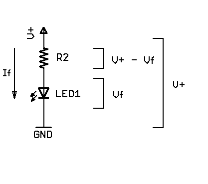

I was curious about how you would go about measuring the forward voltage of individual LED's? I think I know how, but I am not sure.
Its pretty easy.
led_drop1-gif.10803
Credit to philba for posting that in another topic.
Make sure you size the resistor so the led runs at your target current (If).

Its pretty easy.
led_drop1-gif.10803
Don't you have to know the Vf to size the resistor? Regardless, that doesn't make a lot of sense to me? Where would I put the probes to find the forward voltage? On each side of the LED? Or would I take a measurement of the voltage from V+ to ground, before I added the LED and resistor, then after I add the LED and resistor, then subtract after from before? As for the resistor, I assume I would just use the typical Vf for that LED to size it?

Red LEDs are 1.8V to 2.2V.
8 Ni-MH cells are 9.6V and drop to 8V when they are nearly dead.
So three LEDs in series make 5.4V to 6.6V and when the battery is 9.6V and the current is 25mA then the current limiting resistor is (9.6V - 5.4V)/25mA= 168 ohms. The nearest standard value is 175 ohms and then the current is 24mA.
If the LEDs are 2.2V then their current with a 175 ohm current-limiting resistor is 17mA.
If the LEDs are 2.2V and the battery is nearly dead at 8V then the current is only 8mA.
When the LEDs are 1.8V then a charge on 2500mAh battery cells will last for 2500/(24mA x 10)= 10.4 hours. If they blink then they might be turned off for half the time then the battery will last twice as long. Higher voltage LEDs use less current and are dimmer so the battery will last longer.
