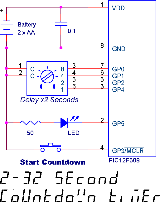

It's funny, the way I'd do this is more a function of my junkbox - a 12F629 + a hexdecimal-encoded switch (plus a couple of resistors). The hex switch would give me 16 possible "bomb delays". 4 pins for the switch and 1 for the LED. Maybe one more pin for a start (reset) switch. smaller, more flexible and probably cheaper. still, it presumes uC knowledge.

I agree. Easy with a PIC. OOps LED is backwards lol.

yeah, that's prettymuch what I was thinking. WPUs enabled.
One problem I've had in running the 629 off of +3V is that the output drivers didn't generate enough voltage or current to drive an LED to full output. I never did get a reasonable answer from microchip on this one. I had a long discussion of this on the microchip forum and several suggested that the mos output drivers didn't saturate at 3V. I dunno, I added a transistor driver and got full output. I don't know if the 508 is different.
