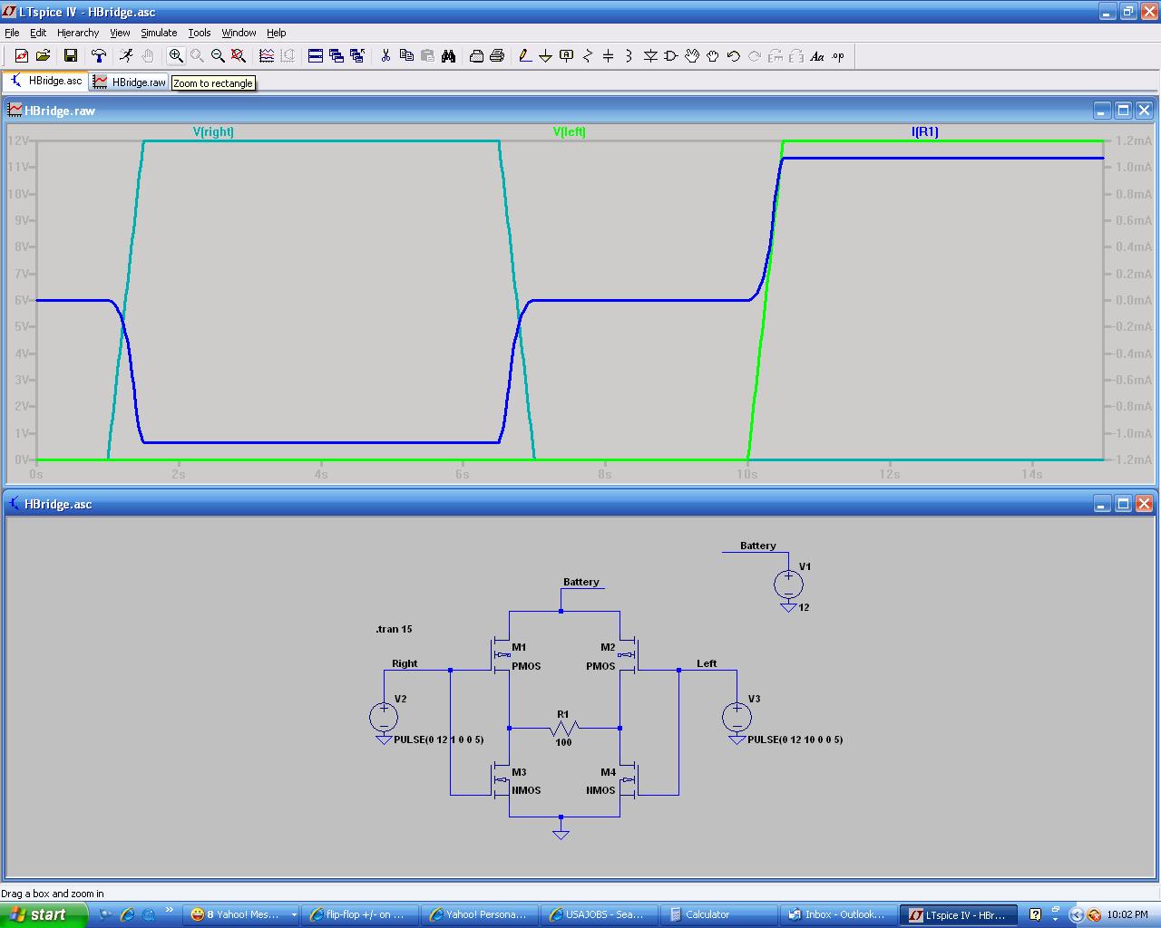

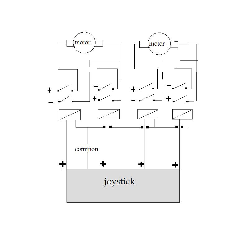

have an old spot light for my boat. The joystick was broken off and I purchased a newer one since I have no idea of the make of the spot light.
So, the spot as two motors up/down left/right. The motors only have two leads. The new joystick has positive out for either of the 4 positions and a single ground.
How can I wire it so the + and the - flip on the motor depending on forward reverse?
