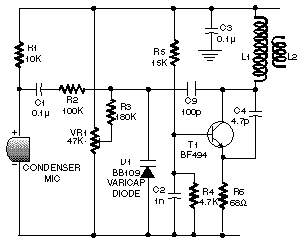

1) Remove L2.
2) Connect the anode of the varactor diode directly to the collector of Q1, not to its emitter.
3) Reduce the value of trimmer capacitor C2 by the capacitance of the varactor diode.
4) C4 causes the transistor to be a common-base oscillator and must be used.
Your circuit has the varactor diode biased oddly. It would be difficult to change its capacitance with voltage.
Varactor tuned FM transmitters have the varactor diode connected to ground so that a positive DC voltage can tune the radio frequency like this one:

yes thanks
i saw transmitters with varactor diode
but still i want to experiment it on ur circuit

now my schematic is okay
ground connected to varactor diode is the ground of opamp connected to sensor
it is not the ground of actual circuit
i have done this so that collector of q2 doesnot short to the ground
