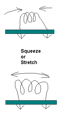

I do have another question though. How do I tune the transmiting frequency of the circuit?
Simply move the windings of the coil apart or together, it's a lot easier to do than it sounds.
Yep,
he is right :D
