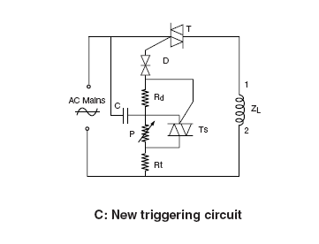

Here is a link to a triac control for an inductive circuit: **broken link removed**
Scroll down and you will see one similar to the one you posted. I would put it in the primary of your transformer.
Could you help with the values for this circuit please

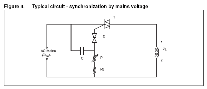

Here's a simpler circuit from that document. Neither of them have a snubber, both are shown driving a reactive load, and this one appears to be an ordinary lamp dimmer circuit.
But by all means, put a snubber on it. Or use a "snubberless" triac.

Can you help with the component values for this circuit please? I am still not an expert to calculate the values.
Melchead, don't let us throw you off track from that original circuit. It seemed like it would work to dknguyen, and it seems like it would work to me, too. Replace that triac with a MAC15SMG, the gate current's a little low for that other one. The cap is .22µF, not 220µF.
thanks i will try that triac. i got it to work in multsim by reversing t1 and t2 on the triac. i did not know that there is a difference or am i wrong?
please advise me
thanks
Yes! There IS a difference! That got me, too, one time. Seems like they ought to differentiate them better, doesn't it?
