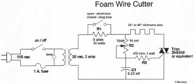

Melchead, did you need to add the diodes and the filter Cap to your transformer, because there is no diodes in the original Diagram for the circuit? Could you post a diagram of your layout/ the components you used (I am in singapore so 230vac is fine for me)
According to the original circuit I should be getting 25vac, 2 amp out of the Transformer (obviously I will only get 15vac, 2amp). Could this be correct, or am I missing something on the diagram?
I have reattached the original diagram for ease of viewing.
James
The circuit as you have it is correct. I did not add or remove anything except my supply voltage is 220ac to the 24vac. just make sure that you are wiring the triac correctly. that was my problem initially. look at the previous posts.

BTW this power supply, if I am correct, supplies a pulse of current across the hot wire which jumps from 0v to 24v and the Triac controls how often the wire sees 24v (?:eek:). If that is the case is there a name for this type of power supply?

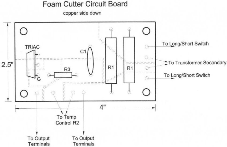

I have got to the point where everything is soldered to the board, but I have realised that I am not getting something.
The variable 5K POT has three terminals and according to the circuit diagram the the middle terminal should be connected to the Gate on the Triac, but according to the board there are only two places to connect R2 (the POT).
In the circuit diagram, where the line from the Capacitor to R2 crosses the line from R2 to the Triac, is this meant to be a node (i.e. all four connected together)? and if it is then I should connect the middle and 3rd pin from the POT to the same place on the board. :confused:
As you can all tell, I am reasonably confused
I have added the Board layout as an attachment if it helps explain my problem
What's the point of R1?
It's a heavy duty 20W power resistor to compensate for having a shorter piece of cutting wire.
This sounds like a very clumsy solution to me.
What about switching a resistor in series with R2 for shorter bows so that when connected, it never works on full power?
It would only need to be a small 250mW 2k2 to 2k7 carbon film resistor rather than an expensive 20W power resistor.

The large power resistor burns off extra heat so a shorter bow can be used.
R2 is a potentiometer which when increased in value causes the triac to fire later in the cycle thus reducing the power level. Because higher values of R2 reduce the power adding another resistor in series with it will make it so it will never work on full power. A 2k2 to 2k7 resistor will enable you to omit the power resistor and can be short circuited just like the power resistor.

Most importantly does anyone know where I am supposed to wire the middle pin of the 5K Pot with regards to the circuit Diagram and Circuit board layout that I have attached below? :confused:
There doesn't seem to be anywhere for it to go on the circuit board layout.

It looks like the wiper (middle) and bottom leg of the pot are connected together. The futher the wiper is up in the schematic the lower the resistance is.
Without seeing the PCB I can not tell you how to mount it.
I would guess that someone forgot to dill a hole. Just short the bottom pin to the middle pin.
Hi 3v0,
I figured it out about the same time you posted, you are correct the middle pin bridges to the 3rd and my supply now works very well.
Thank you for your answer, it has confirmed that I have done the right thing :D
