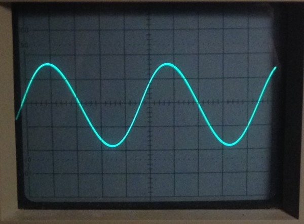

I'm well aware of how a phase shift oscillator works. I've been designing and using them for decades. The circuit I posted follows the standard design. Using a series of 3 RC low pass networks, as you suggested, to get the required phase shift does not work reliably, which is why you'll never see them designed that way.
BTW, since people love to criticize circuits that they've never built, Here's the actual output of the phase shift oscillator circuit that I posted earlier. So, please let me know what part of this sine wave that you don't like.

I dislike the extremely simple single resistor biasing the transistor so one with high hFE is saturated and one with low hFE is cutoff. It also happens as the battery runs down.
Sure, your sinewave looks excellent. But at a frequency not shown and a level also not shown. Change either and it stops oscillating or the diodes show their clipping action.

The back to back diodes look very much like a clipper, which would be counterproductive in a sine wave oscillator. It's better to think of them as non linear resistors combined with the series capacitor to give a non linear RC network. What they do is provide increasingly aggressive attenuation to harmonics while leaving the fundamental alone. Thus, they eliminate distortion, rather than add to it. The series capacitor needs to be sized to suit the frequency range of the oscillator for this to work correctly.

To address Audioguru's comments:
I agree that the single resistor biasing goes against traditional 'good' design practice. The reason why I did this was twofold:
1. I needed to operate this from a single 5 volt supply and still get a reasonable output amplitude. Using a more conventional phase splitter type bias arrangement would give more stable bias, but would limit the output amplitude. (Since the supply voltage in the current application is higher, there's no reason why the bias arrangement couldn't be changed.)
2. Modern components have a much smaller variance of parameters than they did years ago when these biasing arrangements were first analyzed. So, we don't see as much variation in HFE as we did back in our youth. Thus, the single resistor between collector and base is nowhere near as bad as we were taught to believe. With the transistor that is specified, there's little risk of problems. On the other hand if you use an unmarked general purpose transistor from Uncle Fred's House o' Parts, then there are no guarantees.
As for the use of lag filters rather than lead filters, I've never seen it done anywhere in the literature. I have tried it in my own experiments, and it's never worked. One of the problems is that this arrangement is stable at DC, and so there is no need for the circuit to oscillate. If you are aware of a phase shift oscillator that uses lag networks, I am truly interested in seeing it.
Frequency range for this specific example is as I indicated in the previous post: 250-1000 Hz. Amplitude is fairly constant across that range at about 3.5 Vp-p with a 5 volt supply. Across that range, the waveform is very clean, and looks the same as the one I posted.
Regarding the back to back diode thing, see my comments above.

Of course the diodes clip the signal, if they barely affect the fundamental frequency then they also barely cut the dominant third harmonic. Your single capacitor and diodes work only for a narrow range of frequencies. your sinewave looks good probably because the gain was low so it barely works.

2N3904's are el cheapo broad spec transistors regardless of who made them. My circuit called for a 2N5089, which is a higher gain tighter spec transistor.
Your comment about diode clipping leads me to believe that you are one of those people who think that a diode behaves like some kind of switch that doesn't conduct at all until a certain voltage is reached, and then suddenly becomes a short circuit. They actually start conducting at zero volts, and follow an exponential VI curve. By combining this characteristic with frequency sensitive components (such as the capacitor in this case) it's possible to design a very well performing nonlinear harmonic filter. Yes, you do have to switch in different capacitors if you want the circuit to operate over a very large frequency range, but the single value works fine for the frequency range of the circuit I posted.
