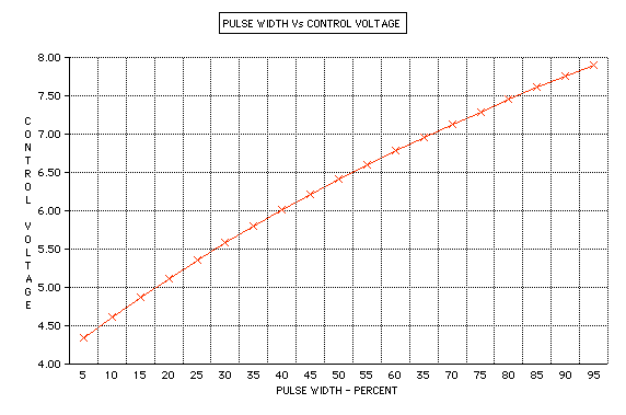

An interesting question which I had never pondered before.

The graph of pulse width variation is interesting. I expected it to be absolutely linear like with an LM331 VCO. In fact, why use a 555 timer with its HUGE supply current spikes as a non-linear VCO when the LM331 is made to do it very much better? I have used it and its performance is excellent.
Yes, me too. But in my mind the 555 would produce linear pulse width variations when it is triggered externally and not in astable mode.
The graph is strange that it plots a certain fixed percentage (5%,10%...etc) against control voltage instead of the other way round.
Hello Screech, is the graph the result of some calculations or obtained from a real test? Is the 555 in astable mode?

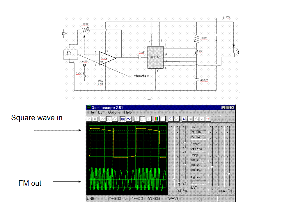

555 timer--FM?
Im curious here because what im doing as shown by the picture below, is inputting a voltage from a microphone(lets say a sine wave of 0.5v) into pin 5 control voltage, in astable mode- as to produce FM output. Now I was wondering does the control voltage only change the pulse widths- is that frequecny modulation at all???
Anyway i wanted to know how much change (deviation from carrier) is expected from a certain control voltage.. because its not on any datasheet.
Im using a much improved 7555, has more accurate timing and much smaller spikes if any.

Hi Electricman,
You have a nice 'scope. I wish I could feed a squarewave into mine and have it show a nice sinewave like yours. :shock:
He, he. Your squarewave and mic preamp give me the creeps! :(
National's datasheet shows PWM and Pulse Position Modulator to be about the same where the top width of the output pulses change in width, producing FM.
With a modulation signal that has a p-p value of 3/5 of the supply voltage, it has an FM p-p deviation of a little more than 2. That should be more than enough for your audio application.

Im using your mic amp cct, thats the old one!!
Is it better to describe what im doing as PPM as oppossed to FM?? because FM shifts the frequency either side of the carrier with respect to an input voltage
Here, from what i understand a falling input control voltage moves the pulses further apart and decreases the frequency
I think I understand how it works but I want to do the calculations. What i needed was a method to calculating the frequency shift caused by a voltage- this seems to have been done by Screech (previous post) in his graph but im using about 200mV, do you think his control voltage is not in volts?? It seems strange that this information is not given in the datasheets.
I don't know. It was a graph I downloaded a long time ago.
I have no other info that came with it, thats why I added the Confused smiley with it. :?

Screech said:

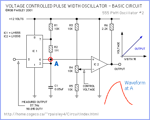

I Did a search for that graph.
Hi Screech, there explains why the non-linearity in the above graph.
Basically, the circuit is NOT modulating the control voltage of 555 but only taken the capacitor charge/discharge voltage and compares it with a user adjustable voltage.
The 555 functions as a astable giving a fixed output frequency. As the capacitor terminal voltage is exponential, that's why the graph is non-linear.
The attached circuit diagram is aslo taken from the same website and I added the red waveform shown at point A.
