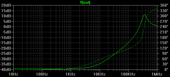

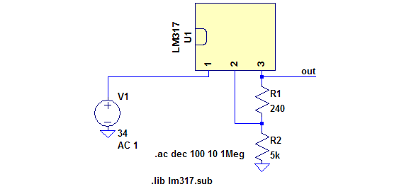

I ran an AC sim in LTSpice. Netlist, schematic, and Bode plot are below.
* C:\Program Files\LTC\SwCADIII\lm317 sim.asc
R1 out N002 240
R2 N002 0 5k
V1 N001 0 34 AC 1
XU1 N001 N002 out LM317
.lib lm317.sub
.ac dec 100 10 1Meg
.backanno
.end
The response peak can be minimized by adding >10uF from the output to GND.
I don't know why your results are so screwy.
