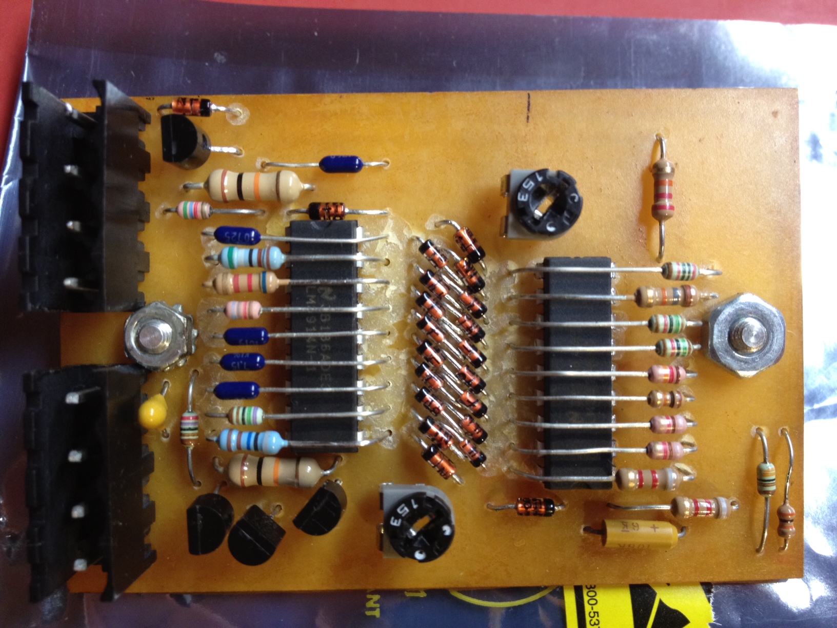

I got this circuit built and installed in the car, but it appears as though only the second chip is working. The gauge reads a little above 50% (I run out of adjustment at that point, not physically on the R28 trimmer, the gauge reading just stops increasing beyond a certain point), and only the diodes going to the second chip are turned on (and their respective resistors show 12.5 V across them). The resistors going to the first chip show 6 to 8 V across them, and their respective diodes are reverse-biased accordingly. Any thoughts as to what kind of design or assembly errors might lead to this particular failure mode? I guess once the battery is 50% depleted I'll be able to ascertain whether the first chip is inoperative or just inadvertently in "dot mode" rather than "bar mode."
Happy new year (which I guess is just a few hours away for you) and thanks again!
Sounds like the second IC is doing its job fine, but the problem lies with the first. One possibility is that R1 is the wrong value (too high), which would reduce the fixed current per stage in the first circuit. Check its value; also that there are no dry joints at its terminals. Double-check that pins 2,4,5,7,8 are wired as per the schematic (N.B. they are connected differently for the two ICs), and that the two lines labelled 'Bus1' are joined.

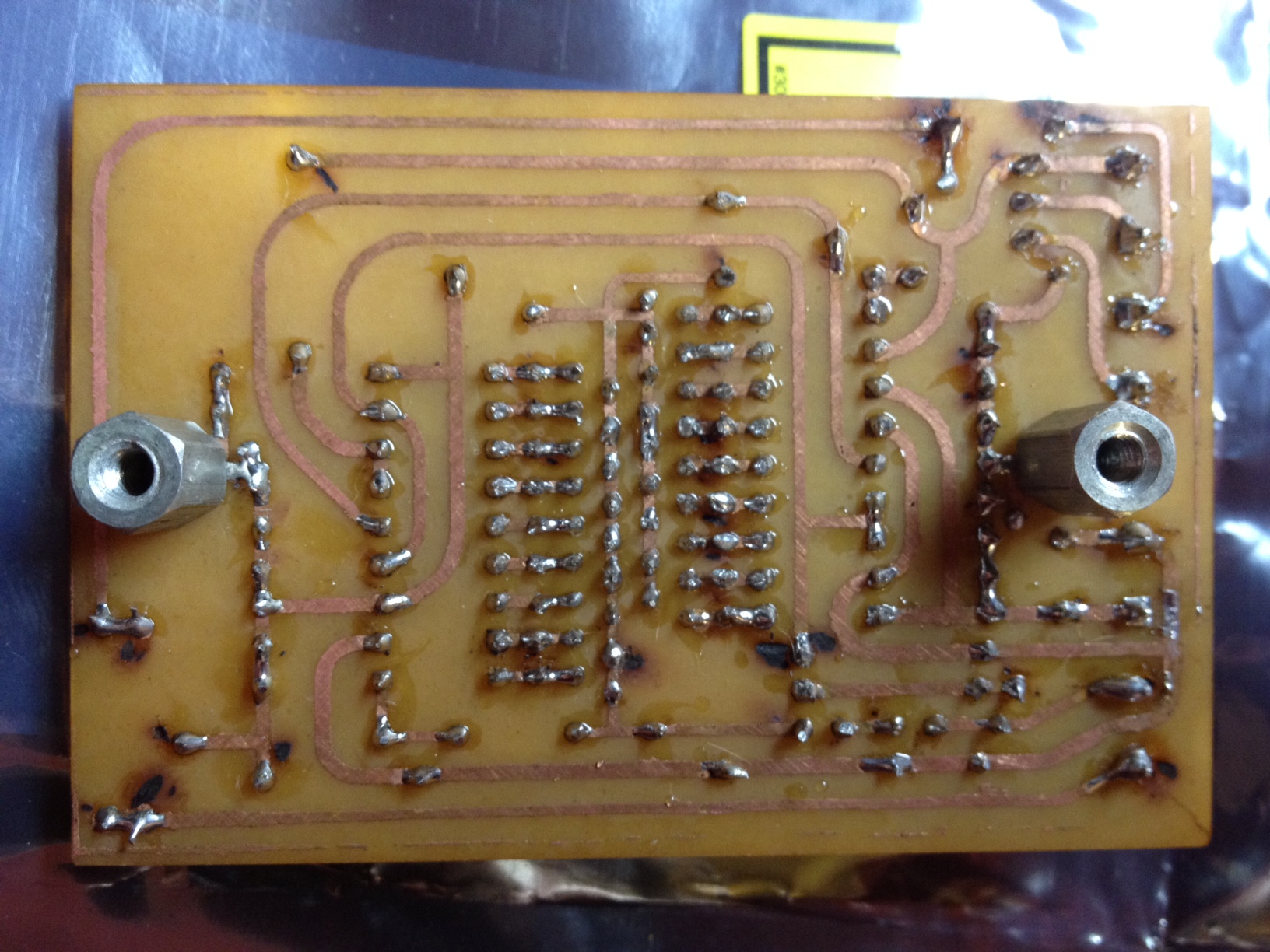

I was able to reach pin 9 with the voltmeter probe with the PCB installed in the car, so I know it's not inadvertently in "dot mode." Hopefully I'll find time later today to take the board out of the car and check the continuity of all the solder joints that could affect the first IC. In the meantime, here are two photos I took of the PCB before I installed it in the car; maybe there's some error that will be immediately apparent to you that I haven't noticed in the course of checking, double-checking, and triple-checking my layout vs. your schematic. If it looks like the second IC is missing its +12 V power source, that's because I ran out of room on the 2" x 3" board, so power for the second chip is provided by a copper bus bar that runs across the two mounting standoffs upon installation. Also note that external connections #2, 3, and 8 (counting from the top) and associated components (2 resistors, 1 diode, 1 transistor) are not part of this circuit (they're for a battery-related warning light on the instrument panel) and that ground/earth is provided on both external connections #1 and 5.

Good pics. It may be a trick of the light, or my poor colour vision, but the third band on R1 (bottom left, pic 1) is ambiguous to me. Is it orange (10k), or dirty yellow (100k)? Looking at pic 2 the solder joint at the right hand (grounded) end of R1 seems dry. Pins 2,4,5,7,8 and the Bus1 lines are confirmed wired as per the schematic.
