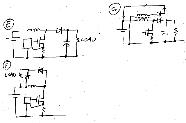

Short circuit in a boost power supply.
E is typical boost supply. If the load is shorted out there is no current limit.
F is a supply where is the load is shorted the IC sees the current and turns off the FET and saves the fuse.
One of the questions is; what happns in a boost supply with no load. If the no load is because something broke in the bridge the voltage will go up to 1000 volts in nS and things will brake.
Circuit G has a catch winding. I have only used catch windings at 1:1 turn ratio. If Vin = 25V the output can not go above 50V because the catch winding will dump any extra voltage back into the input supply. This is how I would limit the boost voltage to a safe level if things go wrong.

A fets generally die shorted, I was thinking about F, but thank you for the idea about catch winding in case something goes open..
