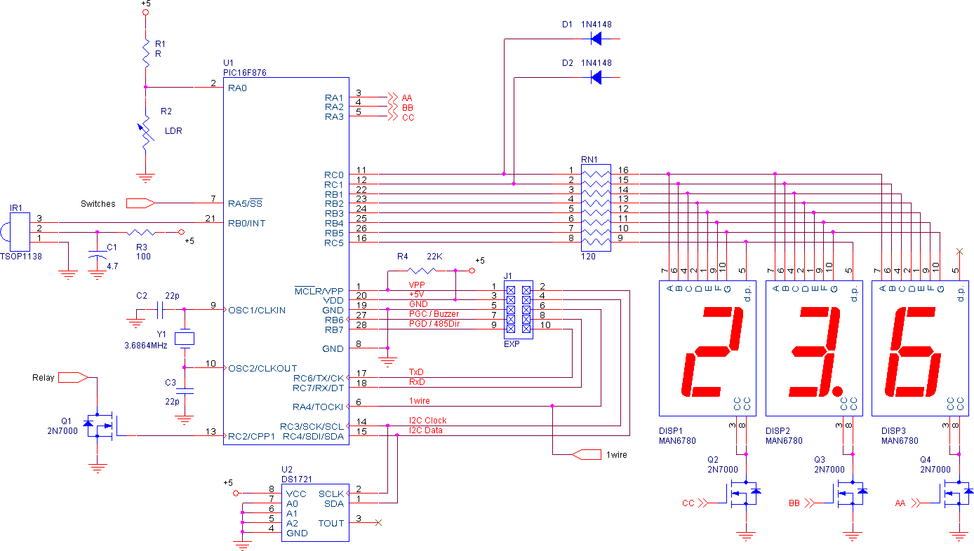

Here's a sneak peak at the Cricket Pro. The expansion connector is also for the ICD2 mode. It's not a complete schematic yet...

Now I'm going to take another look at that schematic William just posted...
