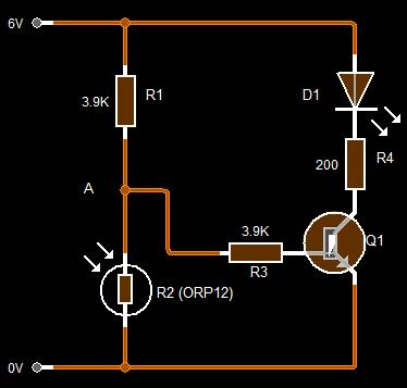

As a self confessed noob, I have been reading loads on Electronics theory and now am at the stage to put it all in practice.
So lets say I try out a simple transistor switch example. The first thing I want to make sure is that I select the appropiate resistors for the job.
Please see attached image file.
This was copied from a book I have been studying, what is useful about this books it gives an insight as to what steps you should go through to select the right transistors.
Please review the following steps and feel free to comment or correct.
1. Understand what the job of the transistor is. (in this case to switch on an led).
2. The LED takes around 20mA and we know the npn transistor (Q1) can take up to 100mA (so its a good choice)
3. The value for R4 is calculated based on the supply voltage minus the drop across the LED (2V) = (6 - 2) / 0.020 = 200 ohms.
4. Lets say that the voltage at point A is 1.5 volts (produced by the LDR + R1).
5. If Q1 is on when the voltage at A is 1.5V then the limiting resistor value R3 is derived by subtracting the base voltage drop (0.7) from 1.5V (at point A) and then dividing by an appropriate amperage based on the collector current and the gain of the transistor.
6. So if the gain of the npn transistor is 100 and the current at the collector is 20mA, then a suitable base current is 0.020 / 100 = 200 microamps.
7. Knowing that (steps 6 and 7) we can do the following
R3 = (Voltage drop at base - Voltage at A ) divided by (Collector current divided by gain of transistor)
R3 = (1.5 - 0.7) divided by ( 20mA / 100)
R3 = (0.8) / (200 microamps)
R3 = 4K (or 3K9 as a nearest value)
I like this, It makes sense and I can work with it. I do have one little question though that will complete this.
At point A there is 1.5Volts, ok - but there is also a current.
My guess is that at A the current will be about 1.5mA (based on 6Volts divided by R1 (3k9))
So when calculating the R3 value connected to the base why not take this current into consideration?
I think I remember reading somewhere:-
"The total current arriving at a junction equals the total current leaving it"
So bearing this in mind lets say the resistance of the photoresistor is the same as R3 (3k9). So at "junction" A would'nt 1.5mA be shared evenly between the base of the transistor and and the photoresistor?
And if that is the case, that would mean more current is going through the base than estimated (or calculated in step 6+7)?
Please feel free to put me right on this one!!!

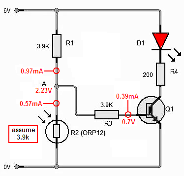

I got rid of your horrible black background.
A transistor has its current gain listed when it has a collector-emitter voltage of about 4V, when it is not saturated like a switch.
A transistor has its max saturation voltage listed with its base current at 1/10th of its collector current so it is turned on very hard.
A high gain transistor saturates pretty well when its base current is 1/20th of its collector current.
Your transistor has a base current of only 0.39ma when the LDR resistance is 3.9k so the transistor is not turned on hard enough to saturate with a low collector-emitter voltage. The transistor might be only half turned on and the LED might be dim.

You need to calculate the base current at step 4. Ib = 20/100 = 200 uA as you said at step 6.
So if you assume that there is 1.5 V at point A, R3 = (1.5 - 0.7)/0.2 = 4k as you found later. BUT, you then have to calculate what value R1 must be to give you 1.5 V at A with a given LDR resistance.
The LDR resistance depends upon the ligh level, so you would need to measure the LDR resistance at the required light level. So assume it is 5 k.
1.5 Volt across 5 k means a current of 1.5/5 = 300 uA.
Therefore, the current through R1 is 300 + 200 = 500 uA.
Thus R1 = (6 - 1.5)/0.5 = 9 k.
This hpow I would have done the calculation, but as we have said, it is not a good circuit if you want rapid switching.
It would be better to eliminate R3. I expect that the person who designed the circuit that was in the book was one of the "transistors are current controlled" school.
But in fact, they are voltage controlled.
If R3 is eliminated, the transistor will start to turn on when the base voltage reaches about 0.55 Volt and be fully on at about 0.7 Volt.
Thus a change of of only about 0.15 Volt is necessary to bring the LED from off to full glow.
Whereas with the circuit from the book, the voltage at point A has to change from about 0.55 Volt to about 1.5 Volt.
