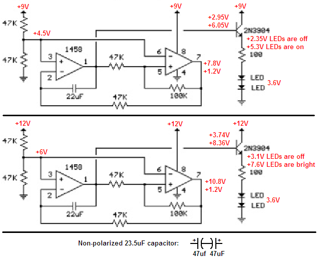

Ok, i think i have run into my first problem...
I wanted to see what would happen if i was to give it 12v dc to 'simulate' what it would roughly be gettin after the rectification and filtering ( i know u said it will be more, but thats why i say roughly ;) )
So i attatched it to a 12v dc adapter and the LEDs dont faid at all and stay on... But they still work fine with a 9v battery :confused:

You forgot to tell us the forward voltage and how many LEDs you have.
I crunched the numbers for two 1.8V red LEDs in series or one 3.6V white or blue LED.
I show the peak voltages.
1) With a 9.0V supply, the LEDs turn off completely and turn on with a peak current of 17mA.
2) With a 12.0V supply, the LEDs get very dim then turn on with a peak current of 40mA which might burn them out.
The 22uF capacitor must be non-polarized. It can be two 47uF polarized capacitors back-to-back. Maybe that causes your problem with the LEDs not turning off with a 12V supply.

Dang, yeah. I forgot to mention that when going to 12V you should change the 100Ω current-limiting resistor on the LEDs to at least a 330Ω to protect the LEDs.
If you don't have a 330Ω resistor you can put 3 100Ω resistors in series.

Yup, worked for me, although when I built it a couple of hours ago I did have some differences in my circuit: I don't have a 1458 around and all my 3904s are in use. I used a TL082 and a 4401 instead. Also, I just used a 22uF non-polarized cap instead of the back-to-back 47uFs.
Worked fine anywhere from around 7 volts clear up to 18 (well, just under 18; I didn't feel like cooking my op amp). The fades got quicker and brighter as I boosted the voltage but it was perfectly happy at 12V. I threw in a third LED just to keep the current relatively safe (didn't bother with the resistor because I only had the thing running for less than a minute).

If the collector and emitter of the transistor are wired backwards then the transistor will conduct like a zener diode when it is supposed to be turned off.
The collector and emitter of BCxxx transistors are reversed from 2Nxxxx transistors.
That could be it. Blckscab, have you tried flipping the transistor around and seeing what happens?

What if he has a huge AC component on the adapter? Just a thought.
I went back out to the shop and tried flipping the transistor with my power supply set to 12VDC. The LEDs stayed off. However, when I boosted the voltage to about 13-14V, the LEDs came on and stayed on. So that could be the problem: the 12VDC adaptor is probably not loaded enough by the circuit to get down to 12V, which would make a backwards transistor conduct like audioguru mentioned.
I just realized while writing the above paragraph that this didn't explain to me why the thing would have worked on the 9V battery, so I ran back out and tried it with the transistor backwards at 8, 9, 10, 11, 12, 13, and 14 volts. The results were as follows:
8V: No action from the LEDs (they just stayed off).
9V: Weak fading on the LEDs.
~9.5-~10.5V: Strong fading on the LEDs; working nicely.
11V: LEDs stayed off.
12V: LEDs stayed off.
~12.5V-14V: LEDs stay on.
With the above results, that might explain nicely why blckscab saw the thing working on the 9V battery, but the LEDs stayed on with the 12V adaptor.
Blckscab, can you try flipping the transistor? Given my above results it seems likely that your results could be explained by the transistor being backwards in the circuit.

im at work at the moment but i will try this out when i get back home and see what happens. I looked at a website to find out what legs of the transistor do what. 1 = collecter, 2 = base, 3 = emitter etc...
So maybe the website was wrong or ive done a silly mistake, but i am using a 2N3904 transistor like the one used in the 'fading eyes' adobe file

You should look at the photo of the transistor showing which pin is which in its datasheet.
Your LEDs have a wide range of forward voltage. If their voltage is at max then two in series will barely light in the circuit when the supply is 9V.
