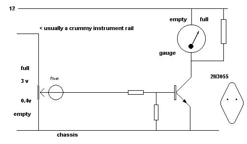

Hi briguy280z,
this is the sort of thing i would do for the fuel gauge.
Auto electrics do not generally take kindly to complex
electronics, the switches etc are usually a bit rough.
The electronics in the alternator is usually way over
12 volt breakdown, and probably well damped.
A 2N3055 is wellover 12volt rated and should easily
handle a few amps before worrying, with a heat sink it
would handle 10 Amps easily. They are fairly common and
shouldnt be expensive.
The arrangement shown is simple, the resistor divider
on the base would determine the current through the
transistor, the one across the gauge may or may not be
needed, to set minimum.
Regards, John

To understand this right the first two resisters adjust the multiplier for the
voltage to the gauge. The guage does work with current flow there are
three connections to the guage Red=Power 12v Black=ground Yellow=Current to ground through the sender
But the Camaro sender sends a .3-3v to the ECM which generates a
square wave sig to the gm guage. (Unusable)
I will work through your solution.

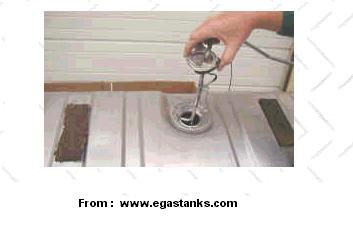

Ive been discussing this with a mechanic friend,
and it was put forward that modifying the sender
would be more practical.
If the float arm is too long shortening it should
be ok, the take-up pipe would probably have a gauze
over it, that could be shortened a bit and the gauze
re-fitted.
I am not familiar with either tank myself, but this
is the advice i have recieved, that it would be more
practical to modify this unit, than to make the
electrical/electronic alterations described.

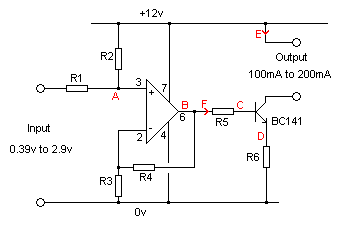

A New Idea
A single transistor in a common emitter configuration won't even
start to turn on until the base-emitter voltage reaches about 0.6 - 0.7v,
it will never go down to 0.4v :!:
If I could suggest a single op-amp circuit...
A non-inverting op amp with a gain of 1.4 (ish) with input biassing...
If the following resistors are used ...
R1 = 2k6
R2 = 9k4 (maybe a 9k1 in series with a 1k preset to set zero)
R3 = 4k0 (maybe a 3k3 in series with a 1k preset to set gain)
R4 = 1k6
... the results would be
0.39v in gives 2v6 in to pin 3, 3.6v out of the op-amp, 3v0 at the transistor emitter
2.9v in gives 4v9 in to pin 3, 6.82v out of the op-amp, 6v22 at the transistor emitter
so I have got the zero and gain close but not perfect, hence the presets.
The transistor should be OK upto 1000mA collector current, or 650mW dissipation,
but will require a small heatsink to cope with this.
It will be dissipating around half a Watt.
R5 is to help limit the dissipation of the transistor and to give some short-circuit protection.
You said the gauge takes about 150mA for full-scale?
If the resistor is calculated to drop about 3v at full-scale (leaving 2.5v across the transistor);
R5 is 20 Ohms, 1Watt

Thanks mechie
Using a 741 Opamp would be my first guess...?
I need a little help with your terminology?
R1 = 2k6
(2.6 kOhm)?
(9.4 kOhm)?
(4.0 kOhm)? 5KOhm Pot so i could adjust the gain if nessary!
R4 = 1k6
(1.6 kOhm)?
Sounds like a good plan though... I agree on the single transistor idea. I couldnt get anything to register under .7v
Thanks for your help
Briguy
A 741 should be good.
Maybe you will need some filtering for the power supply.
Resistor values are as you guessed - it is common to use the multiplier in place of the decimal point, it uses one less character and is easier to spot when printed 8)
For R3 you could use a 5k pot but that would make setting the gain a bit fiddly, a 3k3 resistor in series with a 1k pot would make setting an exact gain much easier, up to you I guess :wink:
For R2 you may want to try the same trick, a 9k1 (9.1k) resistor in series with a 1k pot to make setting zero as easy as possible.
This suggestion was excellent it works the way i wanted it.

Second converter Circuit
Try this then ...
The table below shows my design values for various points on the circuit (red letters on diagram).
If hfe = 45 (2N3055 typ) then ...
 In       A       B      C      D      E         F
0.39v    2.6v    3.8v   1.6v    1v    100mA    1.59mA
2.9v     4.9v    7.0v   2.6v    2v    200mA    3.17mA
gain of op amp = 1.4
so R4 = 1k6
and R3 = 4k0 . . . but see text
You wanted to use a 2N3055, I looked its hfe up as 45(typical), 70(max)
so the circuit needs a gain range to cope with that.
As the transistor is being used as a current amplifier this hfe is important and must be allowed for.
For R3 to allow the gain range required I would use a 1.2k in series with a pot of 4.7k or so.
R1 = 2k6 (decimal point replaced by multiplier, so 2.6k)
R2 = 9k4 (9k1 in series with 1k pot)
R4 = 1k6
R5 = 1k0
R6 = 10R 20Watt - this acts as short-circuit protection for the transistor
. . . . . . and gives some negative feedback to stabilise the output against temperature and voltage fluctuations.
Allow this resistor to dissipate heat :!:
Well i hooked it all up checked it twice. trouble shooted but for
some reason no go?
You said that the hfe was 45 but on the package it says
hfe(min):70 so i dont know exactly what to say. I got two
transistor books comming tomarrow, hopfully they will give
me a clue where to start trouble shooting! :?: :?:
I connect it all up and it constantly stays at 215mA. no matter what
pot i change it does nothing. I measured the votage at (B) and it
varies when i change input voltage and gain pot but amperage
through the load side doesn't. What transistor do you suggest?
I dont mind getting one that might work better, god knows how
much i have put in to get this to work.
Thanks again!
Briguy
Fault finding
OK I have two guesses to start with...
Is the 10 Ohm resistor connected in the transistor emitter line to 0v ?
If this resistor is the wrong value (say 7 Ohms or 12 Ohms) it will affect the operation.
I expect resistors to vary by upto 10% so if it measures a bit low (9.5 Ohm ?) that should be OK.
You said the voltage at point B varies - can this be set up to follow the table I posted (3.8 to 7v) ? If it is close to these values then the transistor is at fault, if these voltages are wrong then the op-amp is wrong.
The transistor hfe :?
OK, a third guess...
IF you have a higher spec 2N3055 than that I looked up then I may have dropped a goolie :oops:
I tried to allow for hfe values from 45 to 70 but if yours is a lot higher than 70 ...
We may need to change the base resistor (R5) to some higher value (you could swap it for a 3k3 or 4k7 to see what happens IF nothing else suggests a fault.
You said that the current to the gauge is in pulses ... could this be an issue ? ...
Could you try the circuit without the gauge, a dummy load of about 30 or 40 Ohms. This will need to cope with 2 Watts of heat so use a power resistor not a little 1/4 watt one :wink: Connect your test meter in series with this to check what is happening.
Hi Briguy and Mechie,
Ive been following this carefully, but i am still a bit
confused about the arrangement of your fuel gauge.
Normally the circuit needed by a fuel gauge is fairly
simple.
Typically the gauge would be in series with a variable
resistor operated by a float.
I am beginning to wonder if this is maybe not the case
here.
I presume you have available the diagrams of both the
fuel gauge system for the datsun, and also the fuel gauge
system for the GZ.
If you could forward a diagram of the original arrangement
of each of these, then i feel sure that a setup could be
easily reached, which would operate your fuel gauge.
electrical diagram of camaro fuel gauge system.
electrical diagram of datsun fuel gauge system.
Or maybe a URL to such diagrams on-line.
This in particular puzzles me:
"When measuring the amps they were in pulses so this is
the best i can get was the peak pulse at the resistant."
Now that would be when measuring the current operating the
gauge (i think)
So you can give the peak current.
So you must be using a digital meter, yes?
Cos a moving coil type wouldn't give the peak till it settled.
Or maybe its a moving coil type, and you gave the reading
as the highest place the needle reached.
The main question to me anyway is, why pulses?
Sometimes, mainly on older cars but not always, the instrument
supply is separated and run at a lower voltage, usually 10 v.
When this is the case, the supply to that rail is sometimes
fed by a 'regulator' from the 12v feed. Such regulators are
primitive units which simply have a hot wire element operating
a pair of normally closed contacts. Over 10v approx the
contacts will open, below 10v approx the contacts will close.
This gives a sort of average RMS of 10v.
Hardly high tech, but very reliable.
With this type of 'regulator' or 'stabiliser' the instruments
need to have fairly low response times, usually they are 'hot
wire' type indicators, this means they are not responding to the
regulators pulsing to provide its 10 volt average.
Now if this is why pulses are happening, then we can work
accordingly.
But it seems unlikely that such a system would be used on a
car that carries an on board computer engine management system.
Unlikely, but not impossible.
The engine management may be regarded quite separately from
the instrumentation.
I would like to check why there are pulses.
Regards, John
