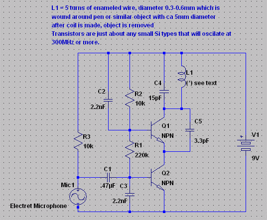

Here is one that is really simple using only few components.
Don't expect too much from it though, but it sure does work...

I'll give one of those a try, just want a transmitter for my cd player and mp3 player since the tape adaptor sucks. How do you put those together so fast, i've built a few and spent hours trying to get them to work with no results. I put them on breadboards but i kept all the leds short and it was all soldered good. Never any luck though
Yes, I built this one when I was going to school. It's a direct FM transmitter, "funny" diode is a varactor diode, kind of like a diode and capacitor combined. As I remember, it worked very well at 87-90 MHz, but you could not tune the full FM band too well. It was crystal clear at 87 Mhz. I used a regular small 9 volt battery.
That's the problem, they won't work on breadboard. Capacitance
between rails is too big for project that runs on so high frequency.
Choose for oscillator transistor with high frequency. For 88-18MHz
you will need trasistor that can oscillate at 300MHz.
How do I make it so fast? Well, it doesn't have to be pretty.
Just get something with holes (sometimes I would scrape away traces
of some old PCB and use just board with holes). Place components
close to each other in a same arangement as on schematic and
make sure pins stick through holes. Bend the pins to secure
components fom falling out. Make sure to join proper ends with
a small bob of solder and that's it for the quick and dirty.
Most of the components are not critical so reasonably similar values
are ok. When missing feedback capacitor (the one that goes accross
collector and emiter of RF transistor, value 3-7pF) I make one by twisting
wires and cutting the length to ca 12-15mm. Some guys
use this type of "capacitor" in parallel with the coil as well to adjust
frequency (cutting the "braid" shorter reduces capacitance and in this
case increases frequency).

While we're on this subject, I built this transmitter, and it will only transmit about 30 feet or so. I used a transistor that had an hfe of about 13 I think it was. hfe means gain, right?? How high of a gain should it have?
As long as it works at all it's high enough, if it's too low it won't oscillate.
All those simple circuits (toys) don't have audio pre-emphasis. Without it, then their sound that is heard on a standard broadcast-band FM tuner (with de-emphasis) will be muffled without high audio frequencies.
Also, of course, those toys don't transmit in stereo.
