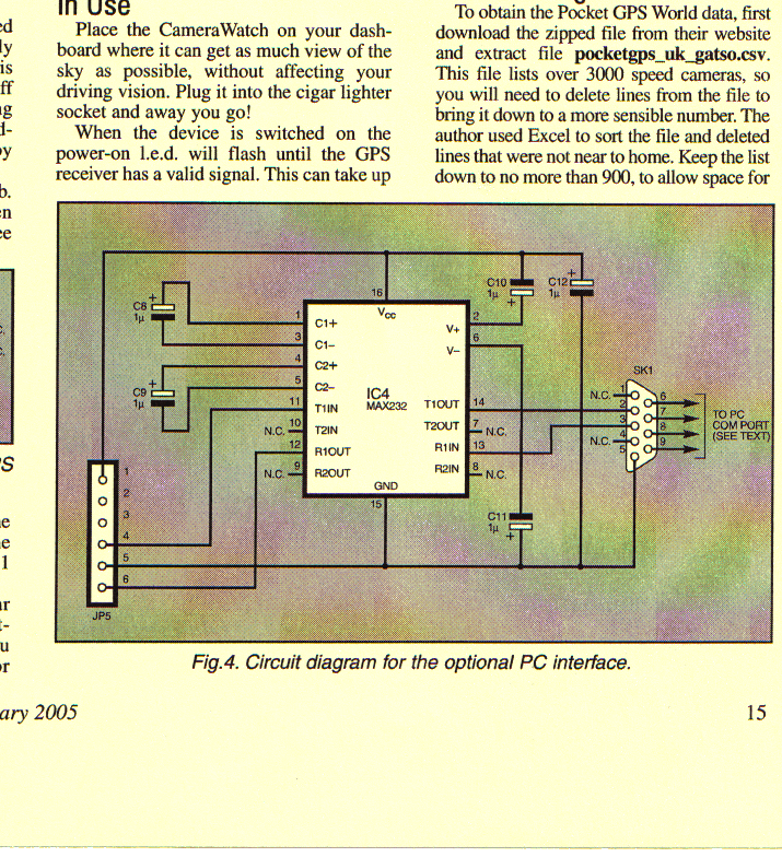

While I am waiting for the PCB to arrive from EPE and the GPS module to arrive from Holux I will be having a go at your tutorials and will go to maplins today for the bits for your main boar. Are there any specific enomolies I need I am also going to get the bits for the RS323 Interface need to download camera locations into the camera watch PIC and is says to use a 9 pin female serial socket - but in my disembowelling frenzy last night i recoverd a 7 pin socket. The plug for the socket is on a 9 pin serial cable I wondered if this could be used in its stead as only 7 pins are actually needed. Please see schematic below
There are usually only three pins required, the ones shown connecting to the MAX232 - I don't know what the pins at the right are doing?, I'll check the article when I get home!.
I've checked the article, the diagram isn't really very helpful?, but I see no reason for more than three wires - the ones to the right of the socket aren't even mentioned at all.

The diagram of the RS232 interface is a little misleading, I'm not sure how that got in (will have to check my copy). The arrows on the right hand side are not intended to be electrical connections, just an indication that the connector goes to the PC. Did you finish the project?
