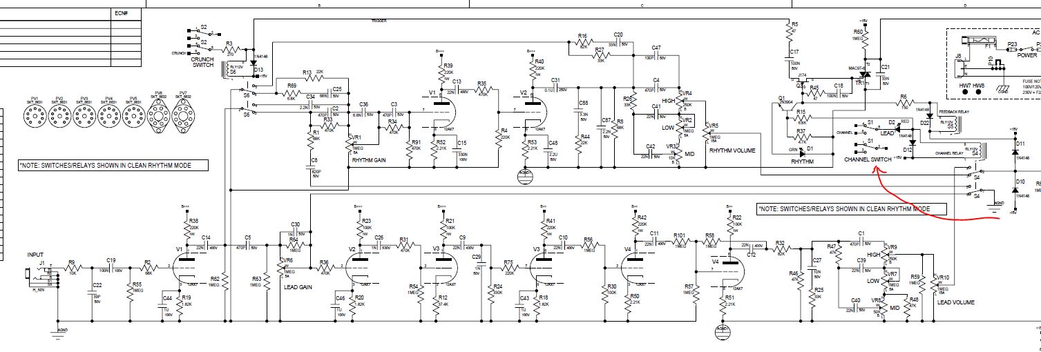

I have a Peavey 6505 112 guitar amp that I need to repair. Suspect some leaky caps.
I need to source caps with the following specs from the BOM (attached a schematic and BOM I pulled from the net):
  • 0.022UF 400V 10% PE AXL (C9,10,11,,12,13,52)
  • 1000PF 630V 10% PE AXL (C6,7,16,24)
Would you say they're electrolytic? C9 etc don't look like it from the overlay though - so its thrown me off.

I suspect those caps because after a while, the lead channel cuts out to very low volume, I can switch to the clean channel and it's back. So something along the lead channel line is broken. I have changed the valves and it's not that. It takes a while for it to happen, 10s of minutes. So if one or two of them is leaky, and not blocking DC completely, then it'll have that effect as the voltage builds up.

No it won't, historically leaky coupling capacitors were a problem (but don't give your symptoms), but those were old crappy capacitors - and almost exclusively one of a couple of poor makes (the worst was Wima, I can't remember the other?).
First port of call on valve amps is the anode loads of the triodes, these ALWAYS go high resistance - you should check the anode voltages to see if they are low voltage, if they are then change the resistors. I would strongly suggest you replace them with higher wattage ones, and preferably metal film - this should stop them ever failing again.

I see one input jack and one output transformer, so it's not clear what the lead and clean channels are.
10 minutes means that whatever the problem is, it is aggravated by heat. It doesn't take 10 minutes for voltages to build up, that happens in milliseconds. But it does take 10 minutes for heat to soak into the deepest parts of the components, make the chassis expand enough to move something one microinch, alter the conductivity of an iffy solder joint, etc. Get a couple of cans of freeze mist, the ones with the long narrow guide tube, and start poking around.

<I can switch to the clean channel and it's back.>
Is this using a SELECTOR SWITCH?
POSSIBLY BAD CONTACTS IN THE SWITCH?
Looks like a switch, I guess for lead guitar, or rhythms guitar. Usually the lead has more treble for those solo riffs. I think. He did post a schematic.
Seems like it would be easy enough to isolate the faulty stage with a scope. Could you bypass a tube stage by pulling it out and putting in a Cap between Grid and ANode? I would think this would allow you to audibly find the bad stage?
