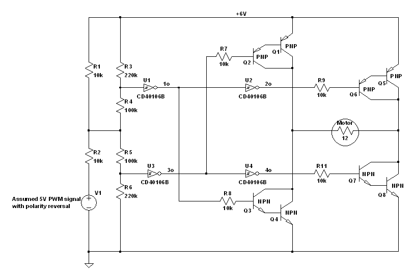

The question is, will an H bridge do the trick? The motor is getting signals at an incredibly fast rate.
Is it just two wires going to the small motor? Those are probably PWM drive voltages. You should be able use them to control an H-bridge and more poweful motor.
Hi Alec, I was also under that impression. Reason being, in a google search a while back I came across a guy building an oversized monster RC truck, and he was doing just that. Now he didnt go into detail wether he used the motor leads, or tapped in before the servo's H bridge.
In a test run I used an LB1641 motor driver chip I found off a circuit board, but it overheated. I dont know if it uses MOSFETS though.
Here's my design which uses CMOS Schmitt trigger inverters to provide H-bridge PWM control signals at logic level, assuming the input signal is a 5V PWM pulse train on two wires, the polarity being reversed to reverse the motor. I modelled the H-bridge using Darlington-connected bjts, but with a suitable interface chip between the inverters and bridge the Darlingtons could be replaced by FETs (the CMOS can't drive power FETs directly).
